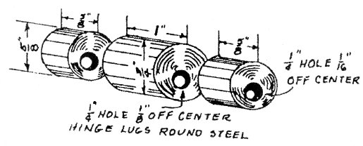

Somebody help me out here... I'm just not seeing the purpose.
Why are the holes drilled 1/8" off center?
Mark Chouinard
Wings, Center Section and Empannage framed up - Working on Fuselage
http://forums.matronics.com/viewtopic.php?p=370465#370465
http://forums.matronics.com//files/hingelugs_113.jpg

That's an easy one, Mark.
The holes are drilled 1/8" off center because that's what the plans show.
I thought you would have known that by now.
Actually, I assume that the eccentricity would be called for to provide a bit of
clearance. Those lugs get ground flat on one side, as required, for alignment.
At assembly, the gear is held together with 5/16" bolts. If the holes were
drilled on center, it would probably be a bit snug to get a wrench over the bolt/nut.
Bill C.
