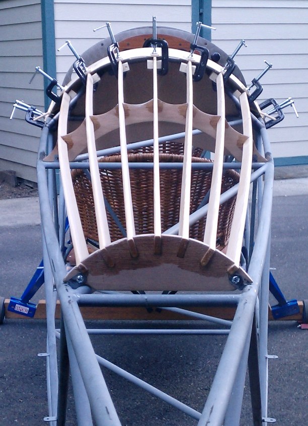

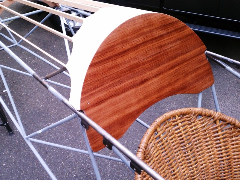

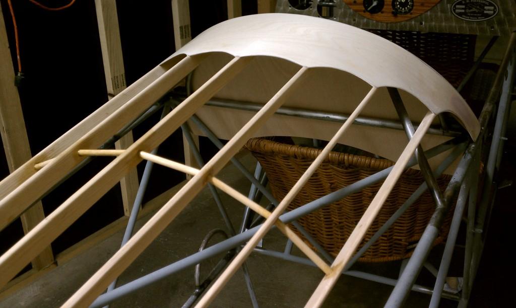

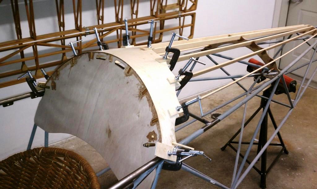

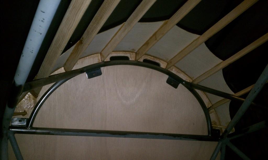

      Hello good Piet-ple...
      Been making progress on the turtle deck and thought I'd share some images.......
      A few observations:
      ==>  It turned out 3.5 lb
      ==>  I do not have a "helmet box" per plans as I am trying to add as little weight
      as possible aft of the CG
      ==>  The 1/16 plywood didn't bend around the contour as well as I had thought -
      so I had to soak it in my bathtub overnight to get it to form. (I let it dry
      clamped in position before I glued it.)
      ==>  The 1/4 inch dowels are glued "1/2 way" into each stringer to stabilize the
      stringers when I cover the turtle deck with fabric.
      ==>  I glued up the assembly, trimmed, sanded, and then added/glued and trimmed
      the "bubinga" veneer. I have since routed the slots for the pilot's shoulder
      harness straps.
      ==>  Having a good time...
      Jake Schultz - curator,
      Newport Way Air Museum  (OK, it's just my home)

      Hi Jake,
      Looking good. I want to lobby you for the helmet box. I don't have one
      on 502Rocket and it is a pain. People don't think the box is very useful
      but when you don't have anyplace to put even a quart of oil (which I put
      next to me on the seat now) it comes in handy. Plus it gives you a place
      to put stuff while you are on the ground at a flyin (for those out of
      sight out of mind moments) like your handheld or portable gps. I really
      wish I did have one.

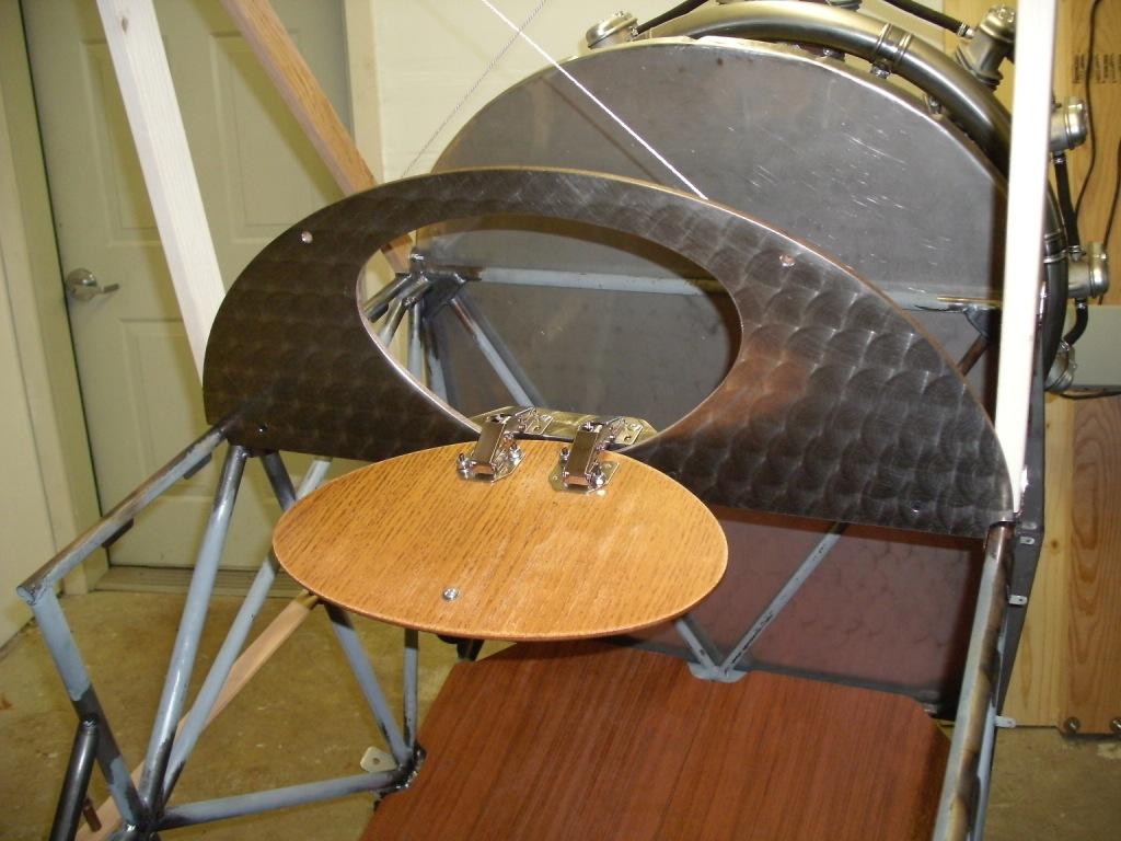

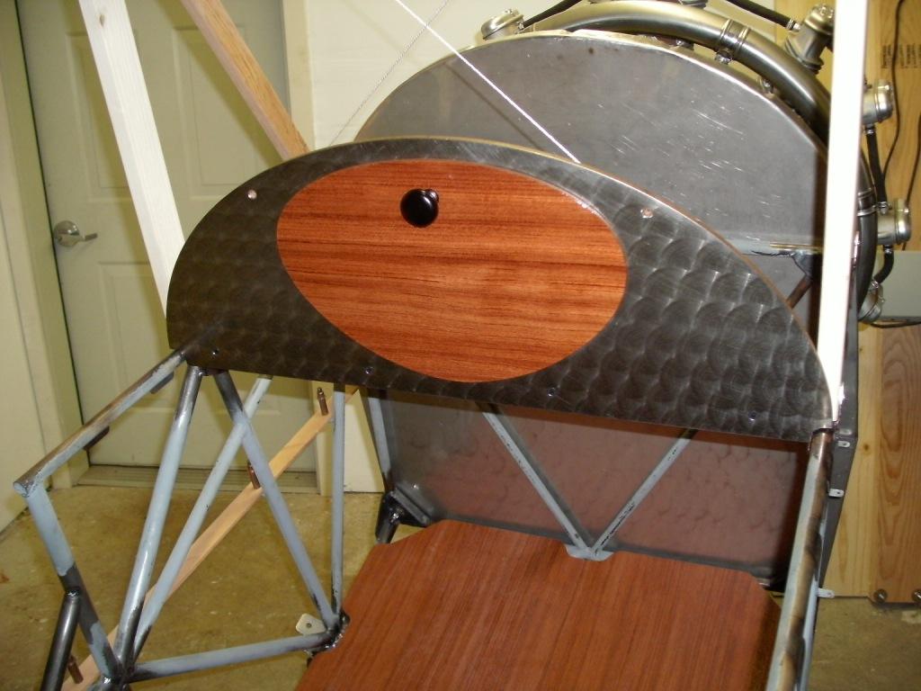

      Thanks for the input John.... I am incorporating a storage area forward of the
      passenger seat. I will have no pax instruments so am using that area as a glove
      compartment - so to speak.  (I've incorporated "modern" hidden cabinet hinges
      to hide the mechanism.)

      So that's how you hide a cabinet....

      Jake those are not AN, shame on you :)

| Subject:  | Re: Turtle deck progress.... 3.5 lb |
      Ha, yep... genuine AN cabinet hardware from Home Depot(!)
      I spent quite a long time in their hardware aisle looking for hinges that would
      work for this situation. I want my Piet to LOOK old but have some of the conveniences
      of today.

| Subject:  | Turtle deck progress.... 3.5 lb |
      I=92ll echo what John said.  I have a helmet box on mine, made from
      1/16=94
      birch plywood on the top, =BC=94 plywood for the sides and bottom,
      routed out to
      save weight, with a little fiberglass reinforcement so it weighs very
      little
      but is a huge help in keeping things that you will need.  In it when
      parked
      at a fly-in I can keep both flying helmets and two sets of goggles, my
      GPS,
      a few essential tools and a couple of granola bars, as well as a couple
      of
      sectional charts.  I use it nearly every time I fly.   Here are a couple
      of
      pics of it:
      Your tutledeck is looking great.  You are going to have a very nice
      Pietenpol.
      little
      weight as possible aft of the CG
      had
      thought - so I had to soak it in my bathtub overnight to get it to form.
      (I
      let it dry clamped in position before I glued it.)
      stabilize
      the stringers when I cover the turtle deck with fabric.
      and
      trimmed the "bubinga" veneer. I have since routed the slots for the
      pilot's
      shoulder harness straps.

      Wish I had done the same...
      Jack Textor
      Sent from my iPad
      of today.
      > http://forums.matronics.com/viewtopic.php?p=373518#373518

      Jake I made the mistake of adding extra stringers for what I hope will
      improve the decks appearance.  I just weighed mine and it is 5 pounds.
      http://textors.com/IMG_4220_640x427.jpg
      Jack Textor
      DSM
      NX1929T
