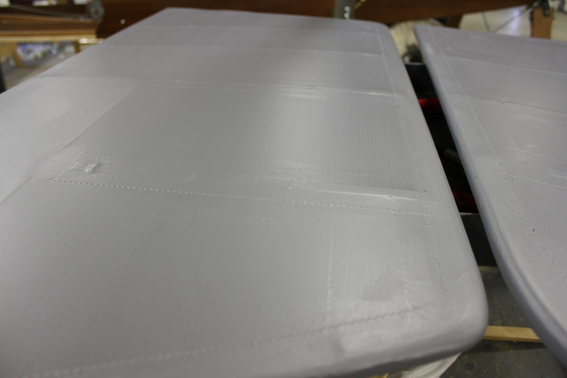

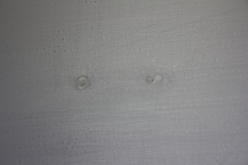

| Subject: | Covering problem? |
I am covering my tail feathers at the moment with SS. everything was going great
until the application of the ecofill. The problem i ran into is ecofill saturating
the fabric and building up on the structure underneath the fabric. Now
that its dry, as i try sanding the surface i run into these clumps of primer just
underneath the fabric stuck to the wood structure and i almost sand thru the
fabric instantly! Anybody else run into this? I was thinking of taking the
small iron and try to mash it flat but im afraid the fabric will stick.....obviously
i put the ecofill on too thick.........it sure didnt seem like it when
i was doing it though.
NX321LR
Fully Assembled less covering
Mistubishi Powered
http://forums.matronics.com/viewtopic.php?p=373748#373748

Message 10
| Subject: | Re: Covering problem? |
Gentlemen --
The EkoFill is used as the filler and is the UV Block. It the the
fabric "primer". Putting on the EkoFill too thick and / or brushing too
hard forces the material through the fabric causing drips on the back
side of the fabric that does what Chris described. I can provide your
with a set of the DVD's explaining the proper method of application and
can walk you through the process too, if needed. It also sounds like
Chris may not have made sure the EkoFill was mixed throughly.
The EkoFill should be applied to the damp fabric, just after washing it
with the EkoClean high strength cleaner. Wipe down the fabric with a
"virgin" (brand new) cotton towel from Costco or SSam's Club (buy in a
bundle) soaked with the EkoFill. Scrub the surface of the fabric to
remove all dirt and grease (oil from hands, dust etc.) with the
EkoClean soaked cloth, turning the cloth often to a fresh surface. Wash
out the cloth frequently in the EkoClean solution and wring out well,
Then go back, again with a "virgin towel" using fresh clean water to
"rinse" the surface, again turning the towel often, rinsing out the
towel and wringing dry. It is important to the EkoFill application that
you leave the surface of the fabric damp - not wet and dripping, but
just slightly damp. This step helps the EkoFill wick between the fibers
to bond and encapulsate the weave.
Do small areas at a time so that the surface does not dry out before you
get to it to apply the EkoFill. Apply the Ekofill with a 3 inch foam
brush (you can use a foam roller on large surface but that is another
technique). Wipe the brush off on the edge of the container so that it
is not dripping and brush on to the surface of the fabric with light
strokes, going in one direction. Go back over the coat constantly with
a "dry" brush tipping out all bubbles and making the product as smooth
as you can. Tipping is using just the tip of the foam brush very
lightly to smooth out any bubbles and even out the coating. A very
light touch is necessary, especially on the first coat, to prevent drip
and pressing the Ekofill through the fabric.
Let dry and repeat the process making your brush strokes 90 degrees to
the first coat. Do NOT sand these first two coats as you do not have
enough build up on the fabric to be sanding. Once those are dry, you
need to spray two cross coats of Eko Fill. You can sand between these
cross coats using a scotchbright pad to just remove the nibs and dust
particles, if you have done a good job of applying the EkoFill smoothly.
Just be careful to not sand through to the fabric and stay off of the
pinked edges of the tapes. You will need to keep ironing down the
pinked edges between each coat using a piece of teflon or a piece of a
turkey basting bag to keep the EkoFill from sticking to the iron.
Chris, you may need to cut that fabric off and reapply, depending upon
how bad the mess is. Your call.
I am attaching my answer to a couple of questions I had from a customer
that may provide some other useful information.
M. Haught

Looks like i missed the wetting step..........I went right to applying the ekofill.
After reading your attachment, i went WAY too heavy cause i can see brush
strokes. I think the parts are savable cause you only feel the globs if you push
on the fabric, you cant see them otherwise. What will happen if i use a piece
of teflon fabric and push on the iron over the clumps? I would think it would
melt the primer clump and flatten it. I really do not want to recover.......i
did a really good job on the taping.
NX321LR
Mistubishi Powered
http://forums.matronics.com/viewtopic.php?p=373770#373770

Message 16
here are some pics
NX321LR
Mistubishi Powered
http://forums.matronics.com/viewtopic.php?p=373794#373794
http://forums.matronics.com//files/img_2502_126.jpg
http://forums.matronics.com//files/img_2501_616.jpg
http://forums.matronics.com//files/img_2500_132.jpg
http://forums.matronics.com//files/img_2499_104.jpg
http://forums.matronics.com//files/img_2498_546.jpg
