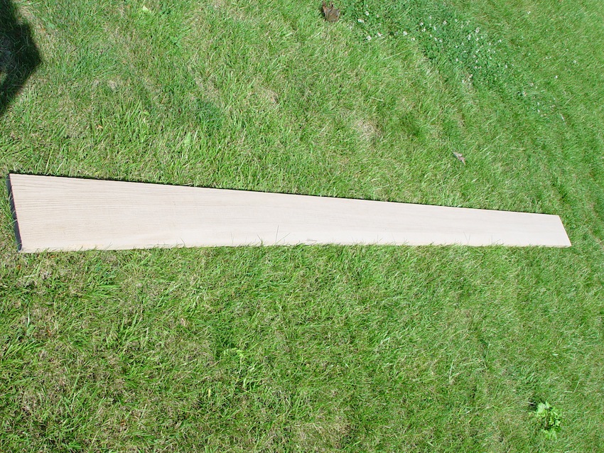

Message 3
      Thanks Jack.  This is the best piece I could find yesterday.
      John Francis
      http://forums.matronics.com/viewtopic.php?p=374356#374356

Message 5
      John, you sure that's ash?  Ash is white, that looks a little redish.
      Jack Textor
      Sent from my iPad

Message 6
      Nice looking wood, but I'm not sure it is Ash.  Ash is white in color, with
      more pronounced grain than this looks to have.

Message 7
      Perhaps its just the shop lighting.
      John Francis
      http://forums.matronics.com/viewtopic.php?p=374365#374365

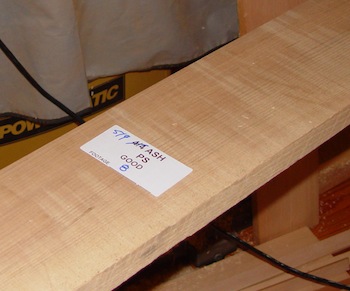

Message 11
      Hows this look in natural light?
      John Francis
      http://forums.matronics.com/viewtopic.php?p=374387#374387

Message 12
      That looks more like Ash

Message 13
      Hi John,
      That looks like the Ash we had at Woodcraft and that I used on my Piet.
      Jim Boyer
