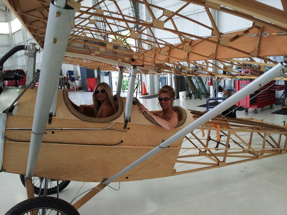

> They improve the look of the piet in my opinion..
> do not archive.
> jeff

Man you know you're starting to get slightly over the hill when you
say "oh yes, those ladies are very pretty" then go about examining
your construction choices and methods Jeff! 'let's see...is that a Model
A or B...' 19" wheels or 18"? Well you just combined two of the three
male pilot's favorite passions....ladies, airplanes, and food.
Mike C.

Ididn't realize the looked naked but now that I look again....well I....uh see
that.
..both in sun dresses ..wife in the back..
Jeff
