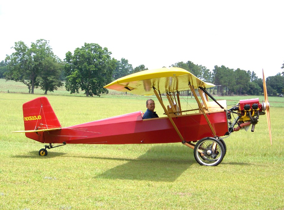

      Is that a good-looking Pietenpol of Jerry's or what?    That's going to get
       up and climb with that big engine.

| Subject:  | Re: tire pressure on motorcycle wheeled Piets |
      Mike my Piet weighs 812 pounds empty. I aired my tires up and just barely took
       the "squat" out of them. I think it was 35 psi. It taxis fine. Just put her up
      from a few runs. I got fast enough for the tail to come up twice....felt good.

      Good report Jerry!   I see  scattered thunderstorms hit or miss across Flor
      ida on
      the radar.  Good to hear you've got some decent weather to taxi test in.  T
      he day
      is still young:)

      I don't know about y'all, but my Piet reeeeeally likes to roll on those big
       wheeels. Its hard to hold her back even in the grass at idle. I recently s
      witched brake lining material (Piet-ish band brakes) and the new stuff work
      s great and really bites in, so much so that I can hold it back on run-up.

      One thing that crossed my mind due to recent experience is adjusting tire p
      ressure to get grandma=99s feather
      bed just right.   Or is that Goldilocks?   Never no mind, but a few pounds
      too much tire pressure in our motorcycle
      tires can make the plane bounce pretty good on landing=94especially i
      f your bungees don=99t have much give.
      I like to keep my bungee cords pretty tight so I have aileron authority in
      crosswinds.  If the bungees are too loose
      you can actually have a strong crosswind get under one wing instead of bein
      g able to dig into it.   Enough about that.
      I=99ve found that 18 to 20 psi in the motorcycle wheels works well on
       pavement.  Your mileage may vary.
      The plus side to higher tire pressures is that your takeoff roll will be fa
      ster.    You play with the pressures and find out
      what works best for your suspension and runway environment.    This all mak
      es me want to go fly.    Think I=99ll burn
      some hydrocarbons soon.

      Yeah, mine likes to roll, too.  My brakes (Cleveland hydraulic disc brakes)
      will barely hold it for a runup and cannot hold it at full throttle.
      Airplanes quit using big wheels about the time they started putting brakes
      on them.

      I have that publication. It is good stuff. Thanks. I have been reading it for a
      month now. I took the gas line off the carb and let it flow into a gallon milk
      jug. It took 75 seconds to fill so that figures 48 gallons an hour. It is raining
      kittens and puppies right now but will taxi more tomorrow. I am going to
      tie her down  and run the engine at full power for 1 minute just to build my
      confidence in it some more. You see I know the mechanic that overhauled it and
      he looked a lot like me.
      Jerry Dotson
      59 Daniel Johnson Rd
      Baker, FL 32531
      Started building  NX510JD  July, 2009
      thru covering and painting, now in final assembly
      21" wheels
      Lycoming O-235 C2C
      Jay Anderson CloudCars prop 76 X 44

       Empty weight was 812#. Heavy but 115 horsepower and 32' 6" wing it should be OK.
      My son is borrowing a digital scale so we can test the thrust it makes tomorrow.
      The famous "fish scale" was not here so my thrust test will not be an official
      Pietenpol result! Right now if all goes well and this stinking low pressure
      will let me Saturday morning first flight.
