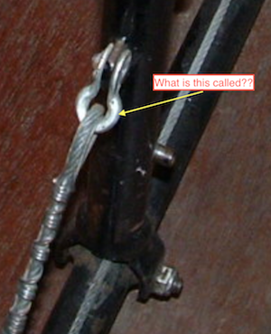

| Subject:  | What is this thingy called?? |
      I will be humiliated to know this has been under my nose all night, but I don't
      know what the part the arrow is pointing to on the attached picture is called.
      Therefore, I am having a hard time finding it online at ACS...
      And I haven't been drinking.
      Anyone? Anyone? :o
      Thanks folks!
      Mark

| Subject:  | Re: What is this thingy called?? |
      That would be a clevis.....
      > don't know what the part the arrow is pointing to on the attached picture
      > is called. Therefore, I am having a hard time finding it online at ACS...
      > Anyone? Anyone? :o
      > Thanks folks!
      > Mark
      > do not archive
      > http://forums.matronics.com/viewtopic.php?p=376045#376045
      > http://forums.matronics.com//files/screen_shot_2012_06_18_at_100758_pm_656.png
Message 22
      Mark,  that looks to be an AN -115 cable shackle.  I used them but many people
      on here will be able to show you  cheaper ways of doing the same thing. The archives
      should be full of ideas for alternative shackles.
      Mike Groah
      > Anyone? Anyone? :o
      > Thanks folks!
      > Mark
      > do not archive
Message 23
      Thanks Ryan.
      Is there a specific kind of clevis, as I can't find one like it in the ACS Catalog
      or online. I see bunches of clevis's but not this style... Looks like a standard
      type for cable assembly but it is not listed with other parts called 'clevis'
      Thanks again all.
      Mark
      http://forums.matronics.com/viewtopic.php?p=376049#376049
Message 24
      Thanks Mike. I will have a look for that. Looks like I was replying to Ryan when
      you were replying to me!
      Thanks. Not sure what to search for in the archives but I'll try cable shackle
      and see what I find...
      Mark
      http://forums.matronics.com/viewtopic.php?p=376050#376050
Message 25
      Oh yeah....! $10.50 a pop! Woo hoo!
      A search of the archives sounds like time well spent to me!
      Thanks again Mike. It was indeed what I was looking for. Dunno how I could literally
      search so many places and not see them.
      http://forums.matronics.com/viewtopic.php?p=376051#376051
