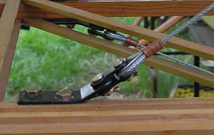

Message 1
| Subject: | What is this thingy called?? |
Shackle, AN 115
Jack Phillips
NX899JP
Smith Mountain Lake, Virginia
-----Original Message-----
[mailto:owner-pietenpol-list-server@matronics.com] On Behalf Of Mark Roberts
Sent: Tuesday, June 19, 2012 1:27 AM
Subject: Pietenpol-List: What is this thingy called??
--> <mark.rbrts1@gmail.com>
I will be humiliated to know this has been under my nose all night, but I
don't know what the part the arrow is pointing to on the attached picture is
called. Therefore, I am having a hard time finding it online at ACS...
And I haven't been drinking.
Anyone? Anyone? :o
Thanks folks!
Mark
http://forums.matronics.com/viewtopic.php?p=376045#376045
http://forums.matronics.com//files/screen_shot_2012_06_18_at_100758_pm_656.p
ng

Message 3
| Subject: | Re: What is this thingy called?? |
Mark find some roller chain, borrow a chain breaker and in a few minutes you can
pull enough links apart to connect everything that you will need. I used #50.
Jerry Dotson
59 Daniel Johnson Rd
Baker, FL 32531
First flight June 16,2012
Started building July, 2009
21" wheels
Lycoming O-235 C2C
Jay Anderson CloudCars prop 76 X 44
http://forums.matronics.com/viewtopic.php?p=376061#376061

Message 6
Mark, I used motorcycle links. Gardiner
----- Original Message ----
From: Mark Roberts <mark.rbrts1@gmail.com>
Sent: Tue, June 19, 2012 2:06:17 AM
Subject: Pietenpol-List: Re: What is this thingy called??
Thanks Ryan.
Is there a specific kind of clevis, as I can't find one like it in the ACS
Catalog or online. I see bunches of clevis's but not this style... Looks like a
standard type for cable assembly but it is not listed with other parts called
'clevis'
Thanks again all.
Mark
http://forums.matronics.com/viewtopic.php?p=376049#376049

Message 24
Hi Mark,
Its called a cable shackle. Look in ACS catalog for cable shackles.
Jim B.
Message 25
Found this picture posted some time ago by Clif Dawson
John Francis
http://forums.matronics.com/viewtopic.php?p=376103#376103
http://forums.matronics.com//files/copy_of_outer_top_brace_fit_100_179.jpg
Message 26
Excellent John!
You know, I knew i had seen other ways of doing the same thing like this photo,
but just could not remember it.
This looks to be an excellent substitute for the $10.50 shackles. unless the whole
thing is $11.00! :o)
Thanks for posting this one!
Mark
http://forums.matronics.com/viewtopic.php?p=376105#376105

The AN111 cable bushings are a better application here than the AN100
thimbles. The AN393 pin will have greater contact surface area. See attached
PDF.
Greg Cardinal

With the discussions of cable making over the past couple of weeks, I
thought I might pass along a tip that was passed along to me by some
of the old timers here at my local airport. Maybe everyone else knows
this tip, but it was news to me.
Attached is a photo of a connector that they recommended for me to use
when fabricating cables. I picked up this connector at Home Depot for
about 3 bucks or so. It works like a charm in sizing and holding
cable lengths with precision. It acts like a third hand, but without
any of the complaining.
Together with the set of cable cutters that I bought at the local
mountain bike repair station for about $20-$25, cable making has
shifted from a dreaded task to something that is simple and easy.
Cheers, Ken
