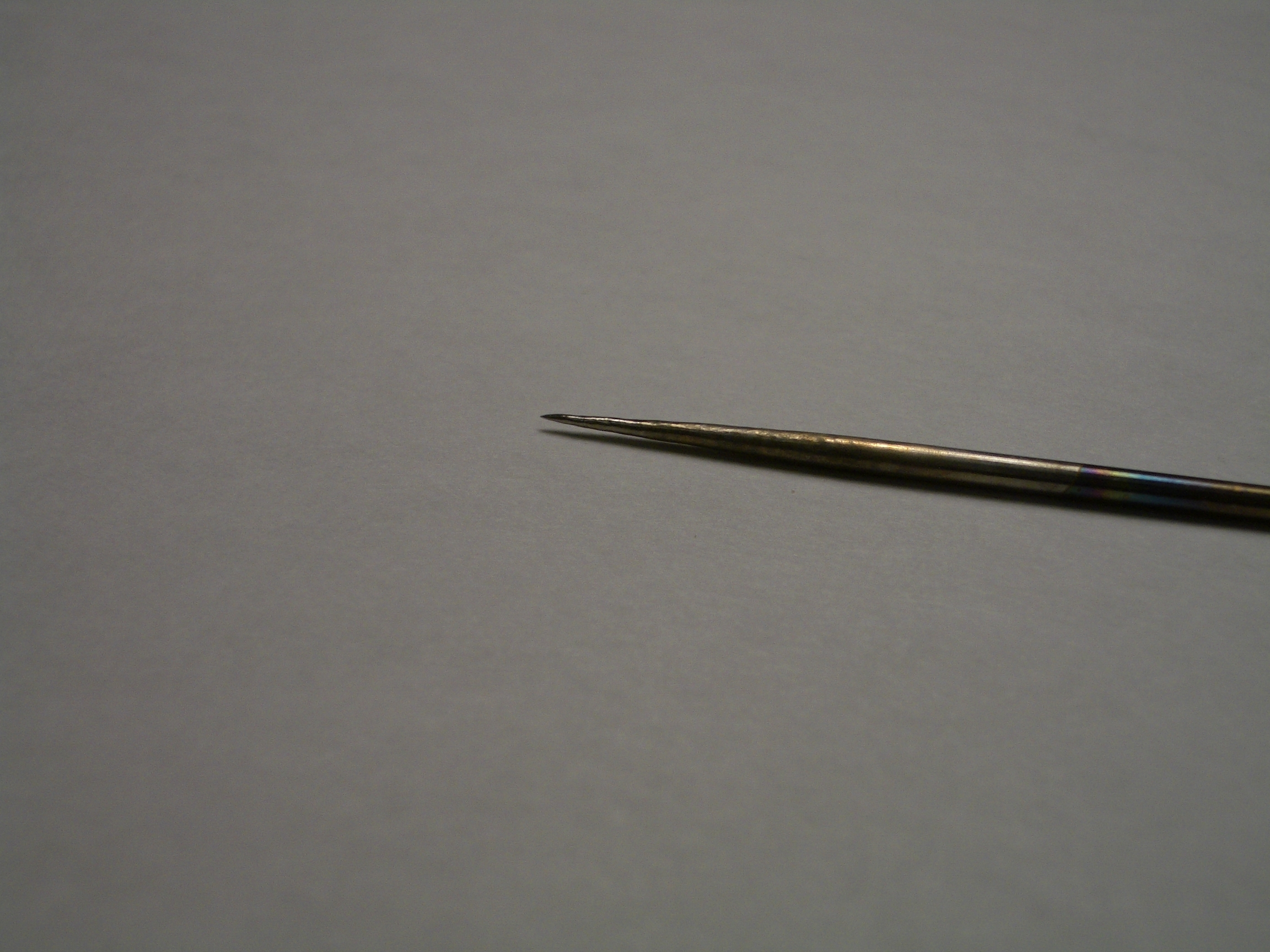

Very interesting. I would to try that. Where does one find a jar of Sodium Nitrite?

> Chemical sharpening:
> You get a jar of sodium nitrite. Hold your electrode in a pair of pliers and
fire up a propane torch and just heat the tip of the tungsten until it glows red
in the flame. Then quickly before it cools dip it in the sodium nitrite powder,
moving it in small circles and up and down a little. A reaction takes place
as the oxydizing salt reacts with the hot tungsten and the tungsten is removed
forming a beautiful smooth sharp tip. You quickly learn that you can control
the angle of the sharpening by how far you dip the tungsten into the pool
that forms on the poweder as it melts and reacts. There are no grinding marks
on the electrode which is what makes the arc wander and difficult to control
on low power thin metal welding where you need fine control. Also grinding
releases fine dust which you don't want to breathe especially if you are using
thoriated tungsten which contains a few percent radioactive thorium. Here's
a photo of a 1/16" lanthanated electrode I chemically!
> sharpened using this technique. Look at the fine tip on it!

It is a food additive for making sausage. You might be able to find it cheap from
a food suuply. Here is my suggestion;
http://www.sigmaaldrich.com/catalog/product/sial/237213?lang=en®ion=US

There is also this advert for a product called chemsharp but it is just sodium
nitrite in an expensive bottle:
http://www.youtube.com/watch?v=drgaJVKxJxw
