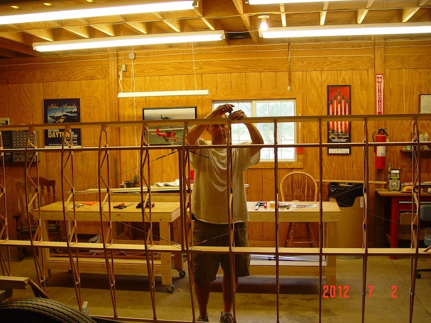

      You just gotta love it.  Although it got up to 93 in my shop today, I managed to
      get the wing hung and began work on the leading edge.

      That's dedication! (The scantily-clad girls must be on the other wall...)
