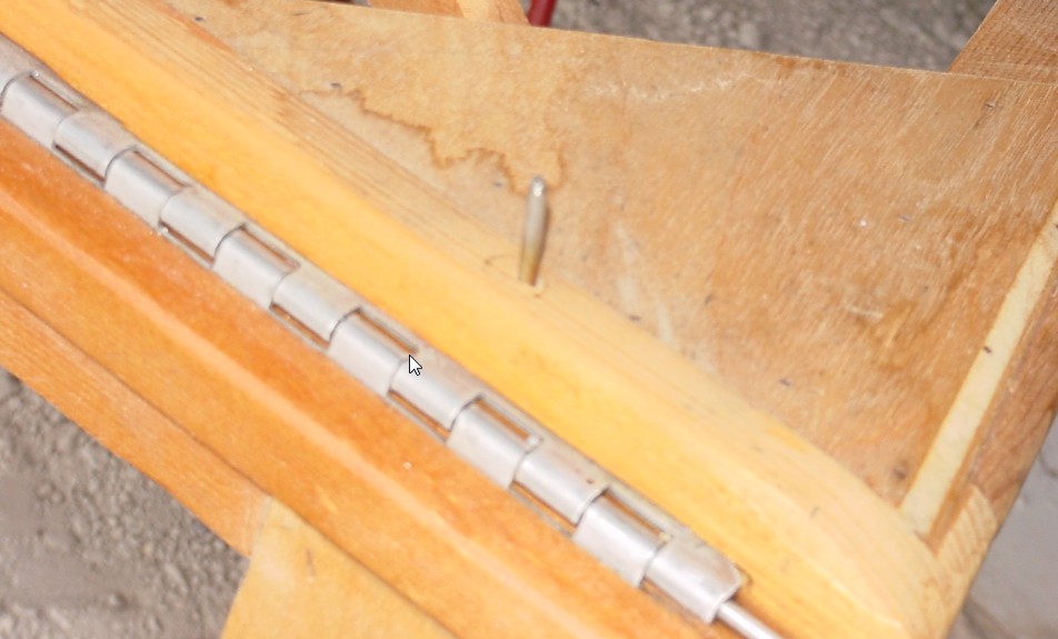

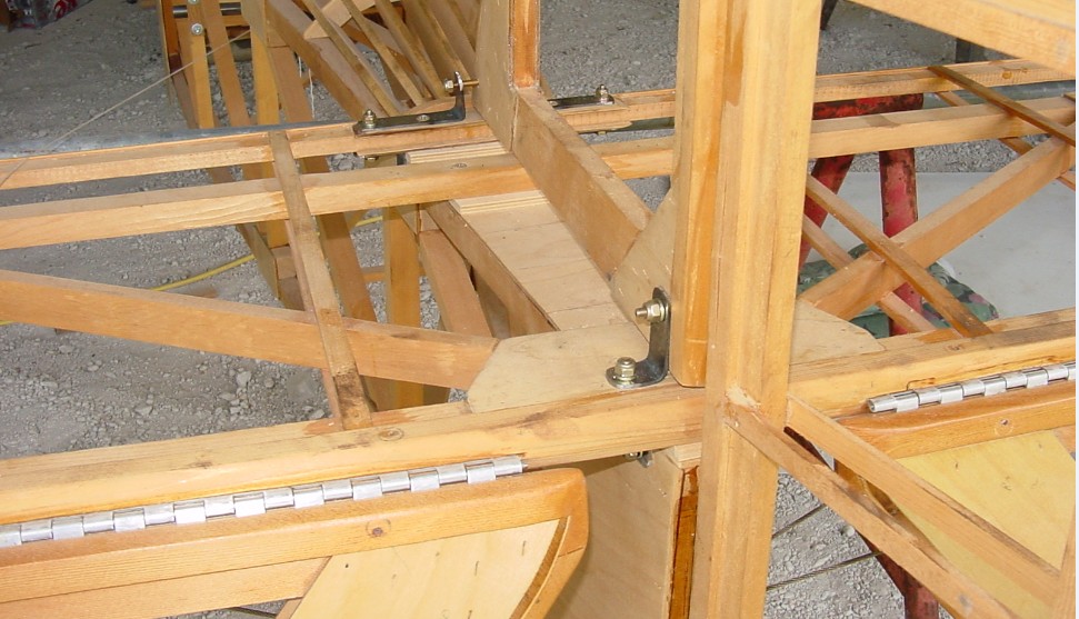

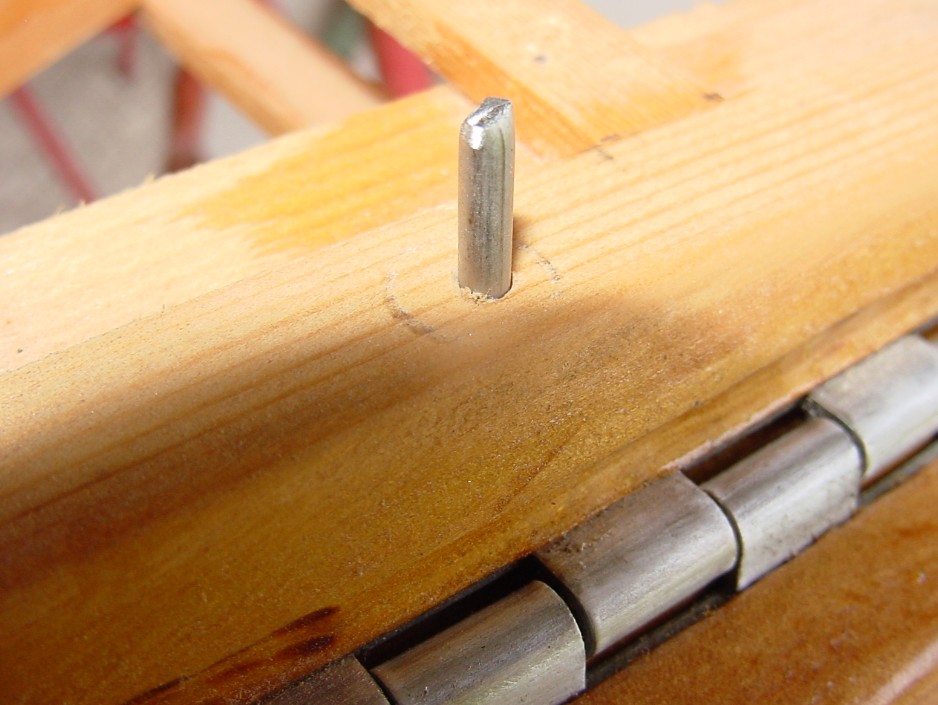

      I used piano hinge on all control surfaces. The way I did it it is a ton of extra
      work but now I like it. The piano hinge is inserted in a groove cut with a
      slitting saw and a router. It is epoxied in and the doubter in me made me put
      1/8" pins in for extra security. Would I do it again.........yeah.
