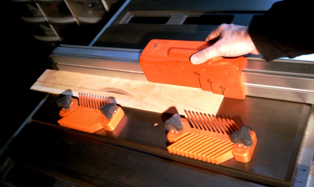

      Here are the photos I submitted... not as clear as I would like.
      The main point is to have the notch on the block pull the part through without
      your hands being anywhere near the blade. The featherboards hold the workpiece
      against the fence.
      Various positioning of the featherboards can reduce the kickback at the end of
      the cut....

      Interesting push block, Jake.  At first glance I couldn't figure out what the black
      "blob" was.  Then I realized that it was to show where the hand and thumb
      are to be positioned.
      But the real reason for my comment is regarding the second photo.  The setup you
      have is unconventional, and probably not a good idea.  You've got two featherboards
      in use - one of them is fine, but the second one is pressing the wood
      against the blade.  Featherboards really should only be used to hold the stock
      against the fence BEFORE the stock reaches the blade, not at the blade, or after
      the cut.
