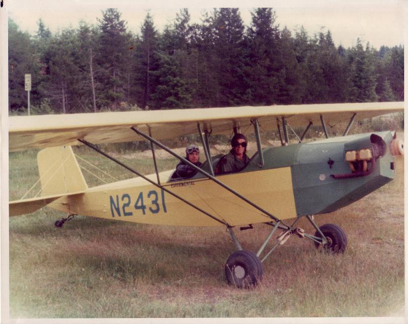

My father and aviation mentor was Paul B. Sayre. Born in 1919, he started a Pietenpol
Air Camper when he was a youngster but never completed it. He was a member
of the Tracy Ace group at the Boeing school of Aeronautics in Tracy California
and flew for Boeing Air Transport, which later became United Air Lines.
He remained with that company to retire as a Captain on Boeing 747 equipment.
The last time he was at the controls of and airplane was out of Port Orchard airport
in a Pietenpol owned by me at the time (the Newberry Pietenpol now owned
by Ernie Moreno). A few things stand out to me about this flight. The last
plane he flew before this flight was a Boeing 747 a few years back. Unlike the
rear cockpit, all he had up front was a plywood panel with a passenger warning
on it. On top of that, all we could find for goggles were some welding goggles
limiting his sight.
Now, get off the ground and hand the controls over to him and watch. He spots
a lake where a friend lives and theyre out on a nice afternoon so he starts to
circle. Im thinking he hasnt flown in a while and has no instruments so I better
watch carefully lest we stall and smite the earth. To my amazement, he held
altitude and speed better than I probably could even with instruments to guide
me. He was an amazing man in many ways, but as a pilot, I was always in
awe with his skill and knowledge. If you want to have fun during Chandelles and
Lazy-8s, have someone taught in the 1930s show you how they were taught to
perform them.
