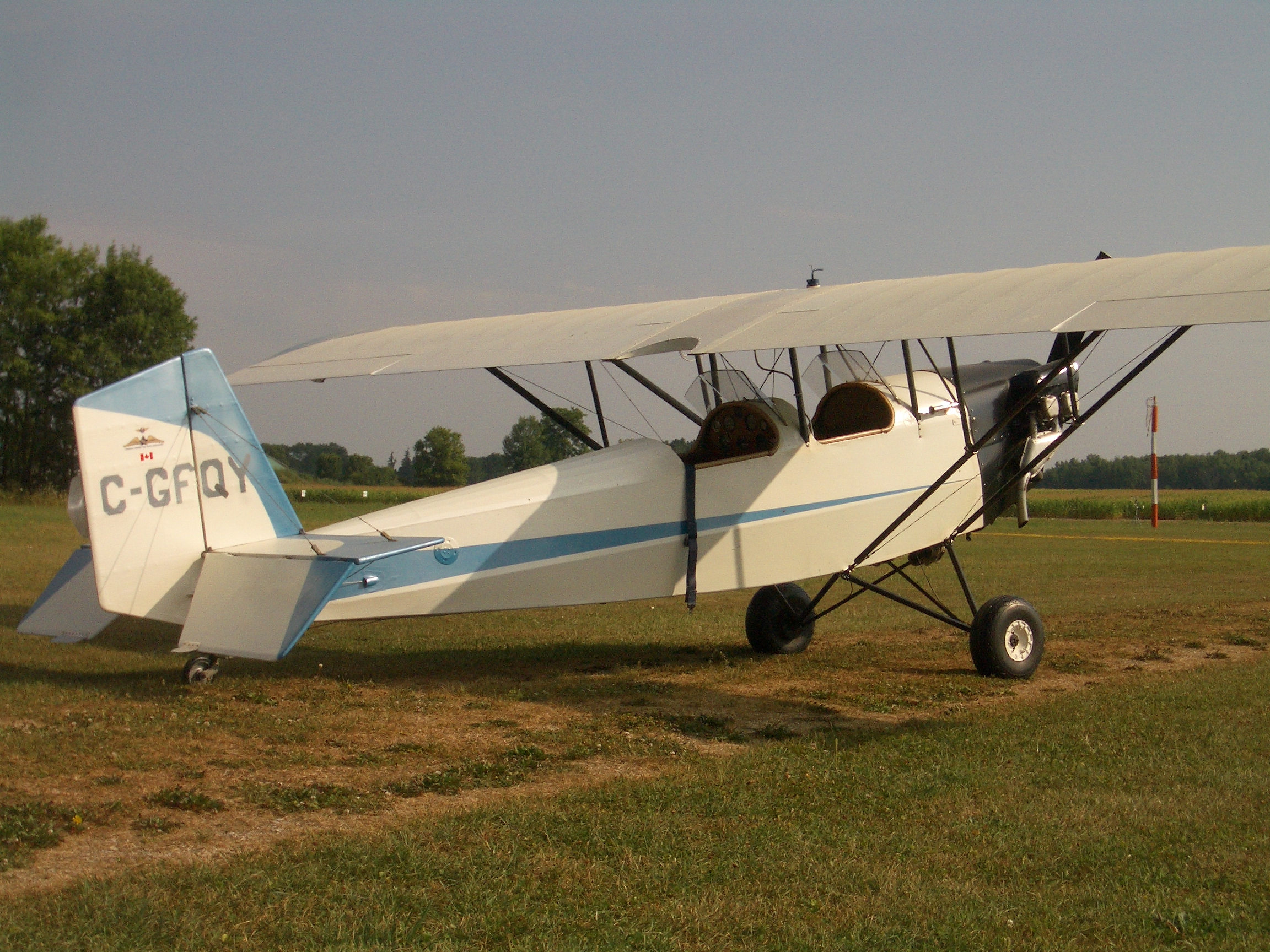

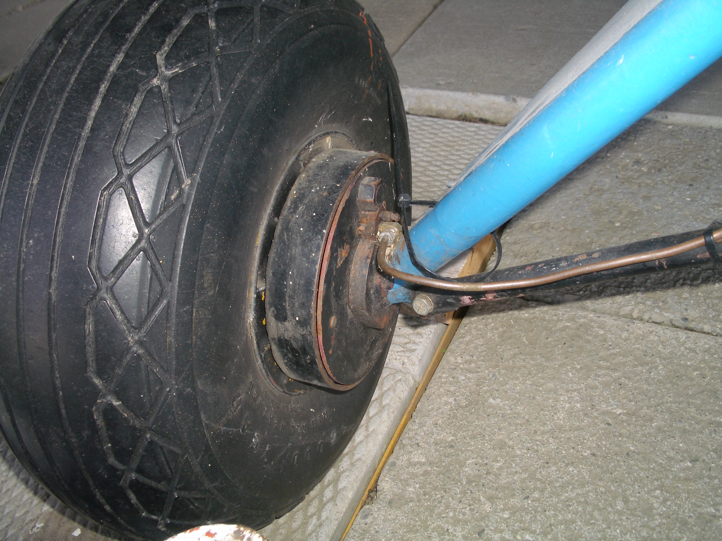

      I'm not sure what you mean by cub vs jenny style axles.  Here is a couple of photos
      of the plane if that helps.
      Joe

Message 9
| Subject:  | Re: motorcycle wheels - bronze bearings |
      Pictures are great. I just did not want to assume what type of gear you had
      , I see clearly now what you have and what you want to do.
      I checked with Buchanan's and you are correct that inside/outside lacing is needed
      when brakes are used.  The reason is that with brakes the spokes have to be
      cross laced to take the torsional load.  Lacing in alternating inside/outside
      pattern allows clearance for the spokes to criss cross without interference.
      All one side spokes would interfere.  If there are no brakes the spokes can
      go radially from the hub to rim and don't have to criss cross so they can be laced
      all from one side.
      I was looking at SS tube/pipe sizes and I think I will go with a sched 80 1-1/2
      in.  pipe which is 1.900 in. OD and 0.200 in. wall which will allow for machining
      the inside to 1.750 in. for the bushings and leave 0.075 in. wall thickness.
      Looks like you went with stainless as well.  Nice job!  I hope I end up with something
      as nice as those.
      Joe
