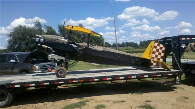

      Wow, an incredible transformation! 7 days from near oblivion. Testimony to
      the man. Can't keep him down. You GO Kev!
      Dan Helsper
      Puryear, TN
      -----Original Message-----
      From: Greg Cardinal <gcardinal@comcast.net>
      Sent: Sun, Jul 29, 2012 5:13 pm
      Subject: Re: Pietenpol-List: Kevin Purtee Update 7/29/2012
      t>
      John Hofman and Chris Bobka visited Kevin earlier today and asked to have a
      n
      update posted.
      Kevin is feeling well enough to complain about the food so he is scheduled
      to be discharged tomorrow.
      He will travel via Amtrak and be home within 24 hours.
      Shipping arrangements for FBG are in the works and she will arrive at her
      hangar soon.
      Greg Cardinal

| Subject:  | Re: I've bought a Piet! |
      Checked my mail... it doesn't seem that David sent any packaging photos, but here
      are a couple from when they loaded it onto the trailer.  According to David
      there was minimal damage... he said that the tailwheel/post area would need some
      attention, otherwise it is intact.
      Mark Chouinard
      Wings, Center Section and Empannage and Fuse framed up - Working on Landing Gear
      http://forums.matronics.com/viewtopic.php?p=379608#379608
      http://forums.matronics.com//files/n7035n_2_119.jpg
      http://forums.matronics.com//files/n7035n_1_173.jpg
