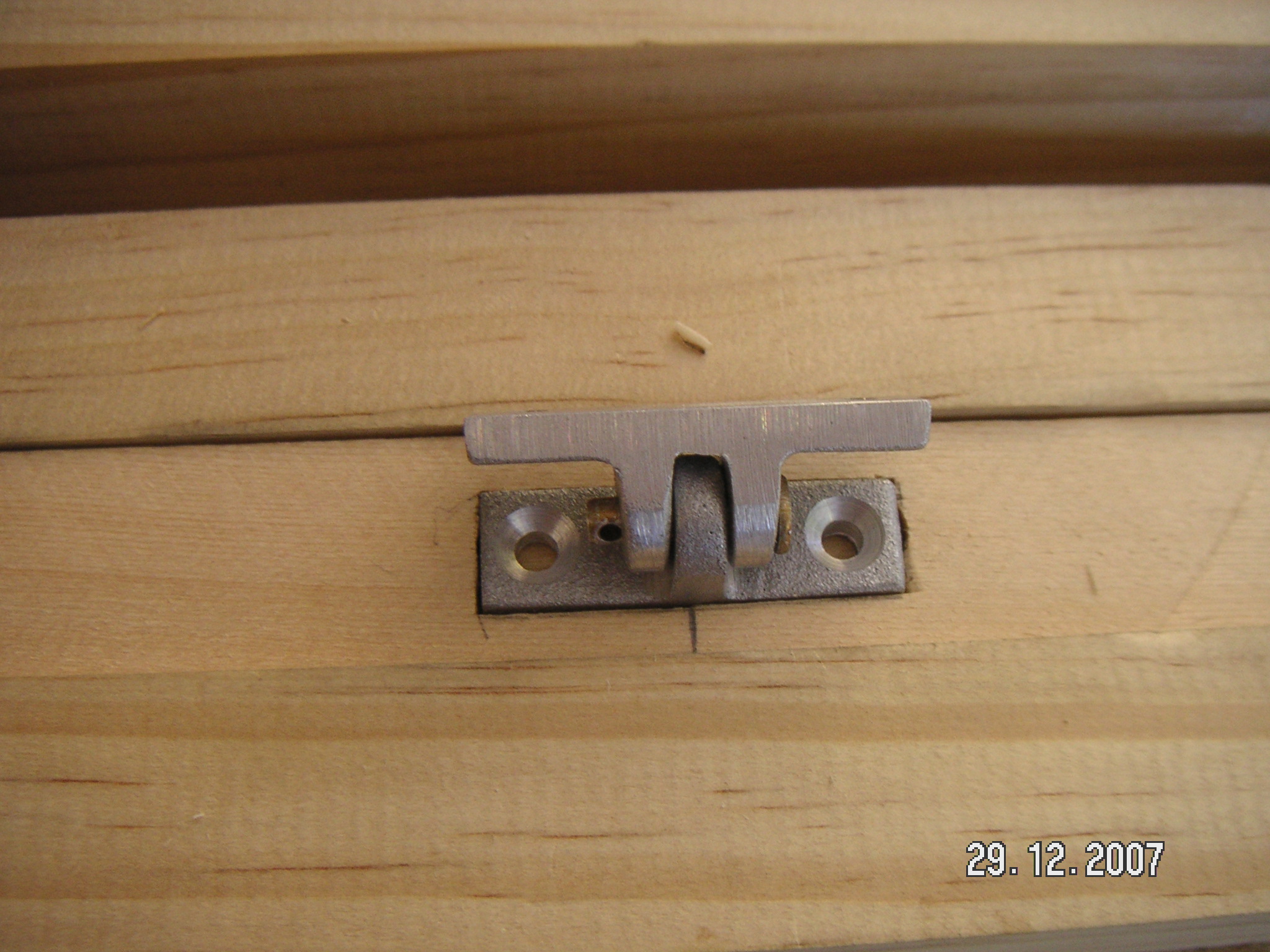

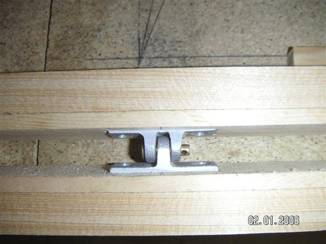

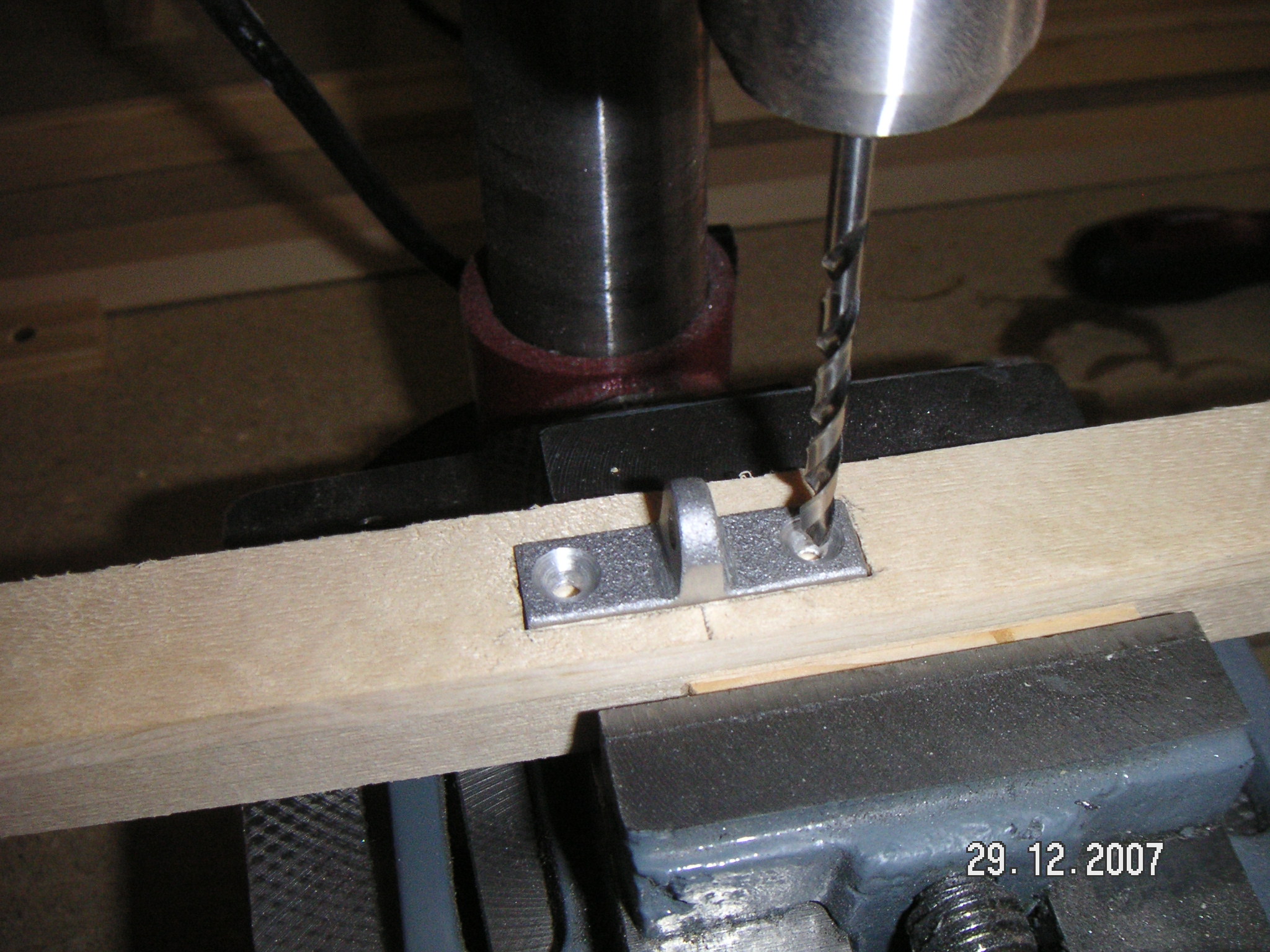

I used the hinges from Vi
I do have his number somewhere but it should be in the archives somewhere as someone
on here gave it to me,If you can't find it I will dig it out
Gee I miss building my Piet

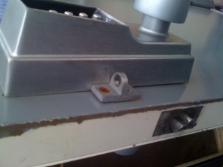

Striving for all the weight savings you can get is a great idea. Curious my
self, I took some pictures of the components that make up my hinges.- Kee
p in mind the hinge shown is larger than the rudder/elevator hinges.

I recently came across Vi's hinges used for another aviation purpose. Holding jetway
doors open. I believe these are stainless.
Curt Merdan
Flower Mound, TX
http://forums.matronics.com/viewtopic.php?p=380238#380238

thats hilarious, is that atl? ill have to bring my screwdriver on my next trip
