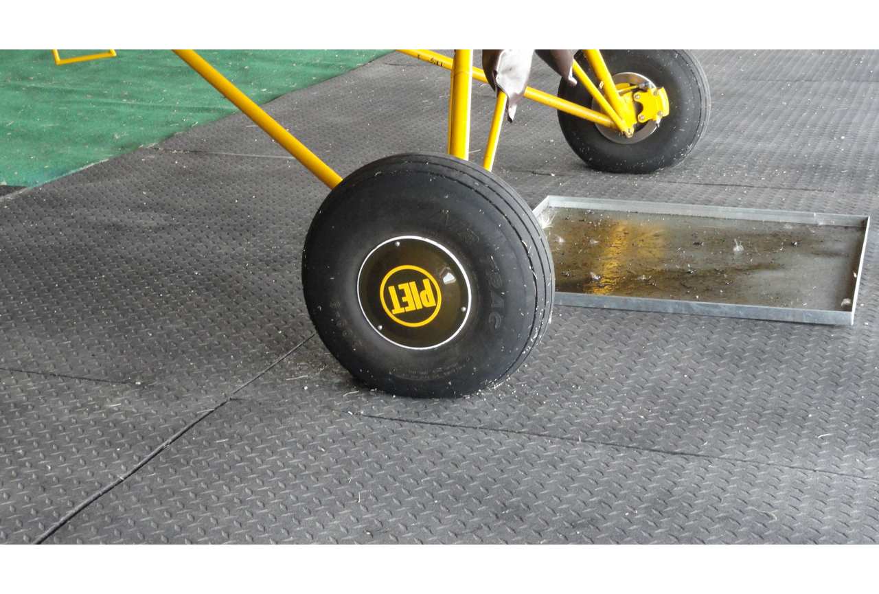

| Subject:  | Re: Brakes: Comprehensive Reference list and discussion |
      My Piet originally had a set of Goodyear wheels and brakes (which were very problematic)
      and replaced them with Clevlands. No more issues with bleeding the brakes
      and replacing lost or broken clips. As mentioned by Oscar, taxing around
      in tight spaces or turning on a dime is easy with this setup.
      PS. I have a half dozen or so clips and buttons for Goodyear brakes if someone
      needs them as you would know now difficult these are to find.
