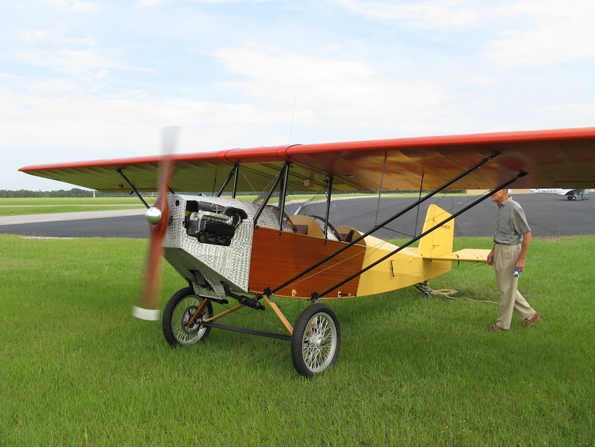

| Subject: | Don Harpers new Pietenpol |
Congratulations to Lowel for noting that the leading edge on Don's new
Pietenpol is a little different . It is actualy a Riblet 612 airfoil.
How does it fly? At this point, I've only done some high speed
taxing. Several minor things were noted and are being corrected
Don is working on getting paperwork together for inspected, scheduling a
DAR, etc.
More about flight information later.

i like that little muffler. does it quiet it down much? and do you have a good
source for it?

Hi P.F.,
Beautiful airplane indeed. The flight testing of Don's airplane will be the
"final word" on the "airfoil wars", right? You and Don were telling me at
Brodhead that his airplane is pretty much identical to yours with the excep
tion of the Riblet airfoil, correct?

Congratulations Don! Nice looking plane!!
Wow, a veritable tidal wave of Corvairs.
Message 6
Answers to two questions from Paul and Dan
Paul-"little mufflers" are empty propane gas cylinders made internally
like a car muffler- seem to work well- can tell you more after first
flight
Dan-After we get Don's plane flying, then I'll do a comparisin test and
write it up for the Piet community. More to come later.
All for now
P. F.

Very Nice! How about a couple of pictures with the cowling off?

Oh My!
----- Original Message -----
From: gboothe5@comcast.net
Subject: Re: Pietenpol-List: Re: Don Harpers Pietenpol
> Beautiful, Don!
> ------Original Message------
> From: John Francis
> Sender: owner-pietenpol-list-server@matronics.com
> ReplyTo: pietenpol-list@matronics.com
> Subject: Pietenpol-List: Re: Don Harpers Pietenpol
> Sent: Sep 3, 2012 8:23 AM
> Looks like a mighty fine aircraft Don! Can't wait to hear the flying numbers.
> I took a nap while the picture was downloading on my computer! Just kidding,
but here is a smaller version of the same for those with slow connections.
> John Francis
> http://forums.matronics.com/viewtopic.php?p=382328#382328
