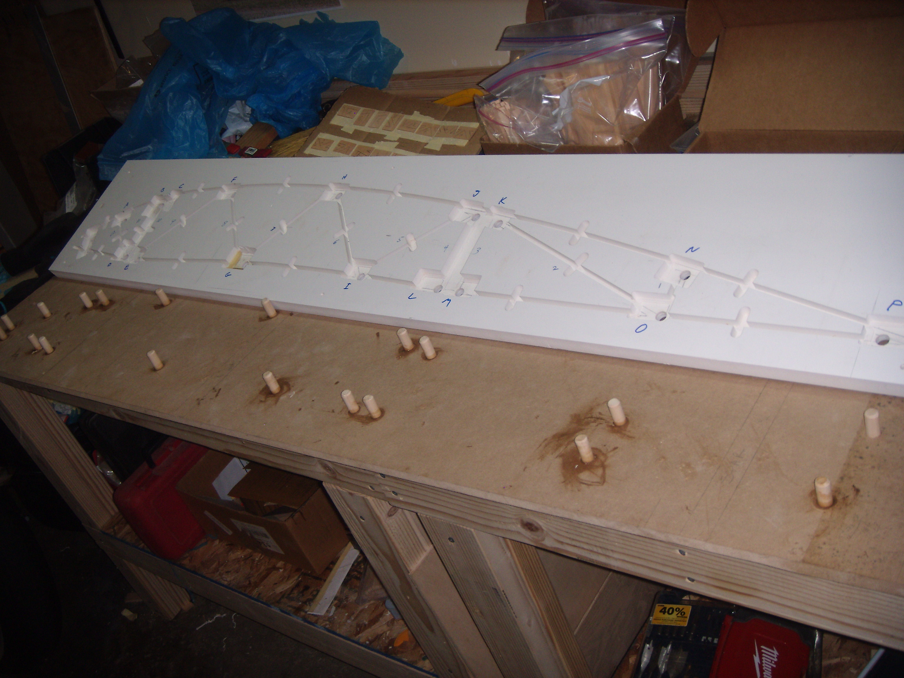

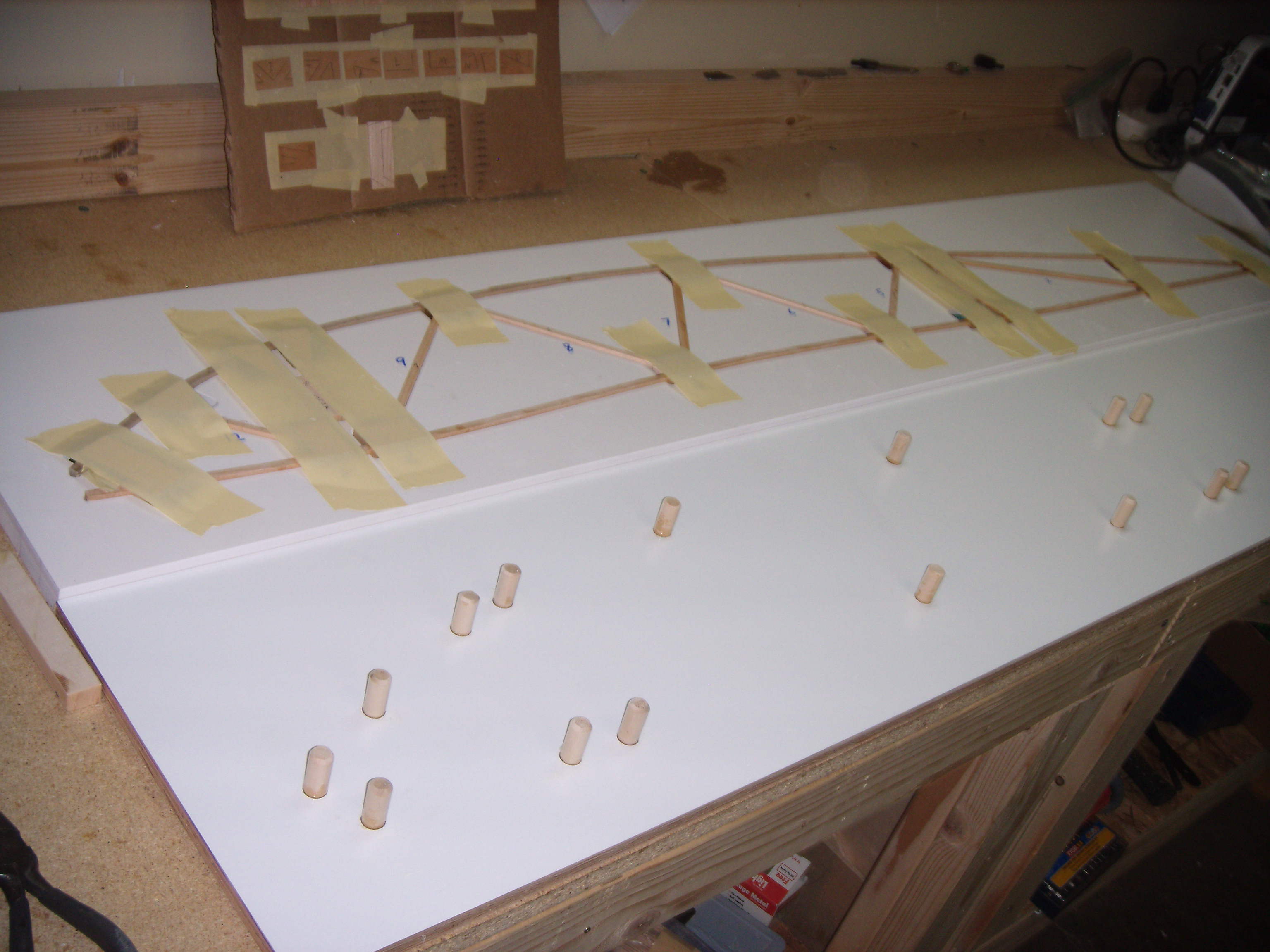

Here is a picture of our rib jig. We drew up the rib in autocad and had it routed
it out on a cnc. The reason we came up with this ideas is being that my father
and I are both building together we wanted to be able to both make ribs
in our own garages at our leisure as we continue to focus on other parts of the
build when we get together. We wanted to ensure that they where exactly the
same. All the gusset areas are routed down about 1/32 so you can inlay and snap
the bottom gussets in place, that way we can glue both sides of the rib up
at once and complete a whole rib per night instead of just one side. After
the first rib my dad came up with the clever idea of making a peg board to remove
the completed rib once dry.
Fred Kim
Pittsburgh, Pa
http://forums.matronics.com/viewtopic.php?p=382701#382701
