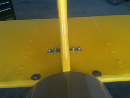

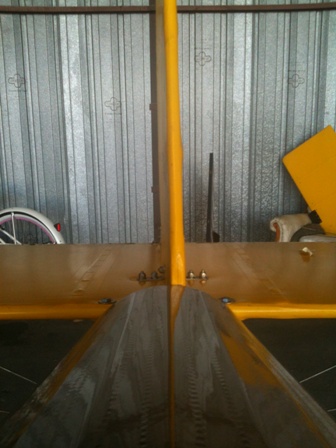

      Hi Folks..
      I have a question for you Piet guru's...
      I've been flying my A65 powered GN-1 for over a yr now. I am not 100% comfortable
      w/having to put a big trim tab on the rudder..even in cruise flight. I even
      built a rear view mirrow to watch it while trundling along enroute to the local
      cafe's. That little wood fixed vert-stab can't be all that strong w/lots of
      rudder in at climb/some at cruise...
      ..then I recently watched Waldo Pfeiffer and noticed the scene they filmed flying
      down Main St in Elgin, texas back during filming in '74...noticing the huge
      offset in the Jenny stab to accomodate the 200hp Hisso's they used in place of
      the weak ol' 90 horse OX-Fivers..(the scene where Axel is screaming; "Marybeth!".....
      "Marybethhh!")
      1. How much is the right amount of offset for the A65?
      2. Anyone else have this concern?
      I'm just eyeballing it, figuring any offset is better than none, but don't want
      too much either. I am starting with just over a half inch (9/16")..
      I attached a short vid. Somewhere about mid-vid, I shine camera into mirror to
      watch it, but the video appears to show less rudder than it seems to require in
      real life. (rudder deflection not as pronounced in real life). Will attempt
      foto attachment as well... Thx in advance, Larry
