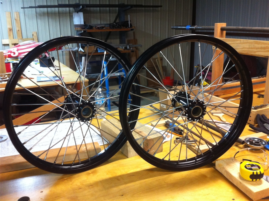

After several months of waiting, I finally get to look at my completed wheels.
I purchased my hubs from Ken Perkins back in the spring and sent them out to
Buchanan's to get spokes cut and rims drilled. Received them back on April 19...
had them at the powder coater April 20, and then they sat at the local motorcycle
shop for over two months! I finally just went and picked them up with
the intention of lacing them up on my own sometime. Well, sometime finally came...
a friend of mine stopped by the hangar the other day... as he's looking
around he says, "what with those wheels?" I explained that I wasn't ready to
pull my hair out yet, and that I was saving them for a cold winter day. He grabs
a rim, a hub and a hand full of spokes and proceeds to lace one up in under
an hour. I forgot that he was a bicycle guy, and it never dawned on me to
ask him for help. He came back by last night and laced the other one, and now
has them at his house on his truing rig. As much as I wanted to learn to lace
wheels (not)... I sure do appreciate him getting them put together for me.
Mark Chouinard

Your wire wheels look great Mark and way to go, hat's off to the gent who laced
and is truing your wheels for you. You could easily
do this yourself but the learning curve is steep for the first wheel but as with
all Pietenpol building the second 'anything' goes much faster.
They look great--are you planning on using any brakes? Steel landing gear legs
or wood?
Mike C.

Thanks Mike... I'm sure I could have done it, but wasn't something I was looking
forward to. With a fellow standing there that wanted to pitch in, I was glad
he found something he could accomplish. Some things I really want to do on
my own without a bunch of you know what I would do comments or interruptions...
wheels isn't one of them.
In the process of building steel tube gear and plan disc brakes with the Comet
calipers like many of you are using.
Mark Chouinard

has them at his house on his truing rig. As much a!
s I wanted to learn to lace wheels (not)... I sure do appreciate him getting them

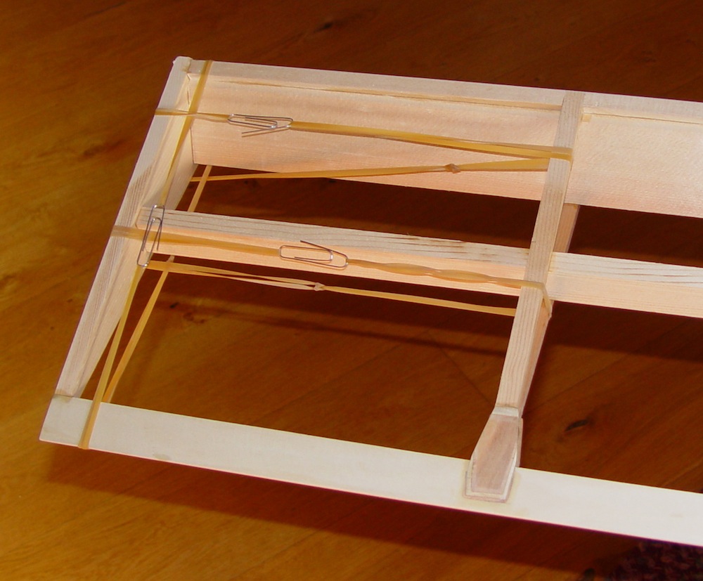

Today I glued up more of my aileron and mounted the piano hinge to the aileron
spar attached to the wing. Now I must figure out how to accurately mount the
aileron to the hinge. If you've done this before you will know what I am talking
about and the challenges of marking the aileron spar correctly. Any bright
ideas out there?
John Francis
