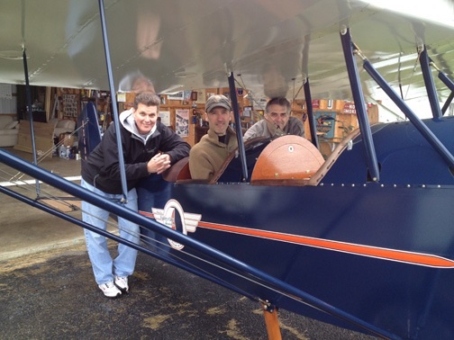

Dispute the cold gray day- had a great
visit with Mr. Cuy over the weekend
First time I've seen the plane in person
It really is a beautiful job!
Thanks again Mike for taking the time
And all the info
Earl
