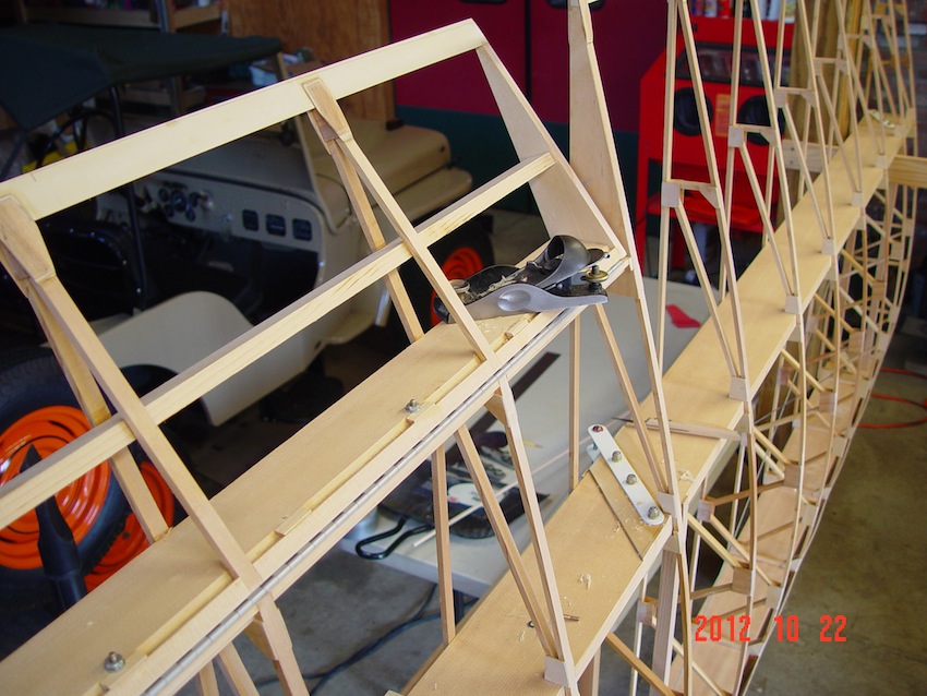

I didn't know if we are supposed to glue the ribs onto the spar or just nail them
in place as shown on the plans. Once the fabric is shrunk that should be enough
to hold them in place right? We are getting ready to varnish and I'm thinking
it will be lot easier to varnish the ribs before they are on the spar but
don't want to varnish the areas that will be glued.

Fred-- there are lots of ways to do this but I preferred to glue and nail the ribs
to my spars---not required but it gave me assurance
that they weren't going to move around. Technically after you tighten your drag
and anti-drag cables the ribs should not be able
to move anywhere and some guys have done it like this without glue or nails but
for me I just wanted a dab of glue and two nails,
nothing fancy but enough to satisfy me.
I know the weather in PA isn't conducive to this right now but I ended up spraying
my wing with diluted spar varnish (mineral spirits to thin)
on a set of sawhorses on a limestone driveway back when I built my plane and that
worked like a charm. I used a Hudson spray container
or bug sprayer like you'd find at a garden department and I think it was a 1.5,
2.0 gallon plastic one. The varnish gets in all the nooks and
cranies and you have to flip the wing over of course a time or two while drying
so you minimize drips but overall it was a great, fast, and easy
way to do the job. I ended up using Helmsman Quick Dry spar urethane from Lowe's
or Home Depot and thinned a bit more with mineral
spirits so it would spray well. It took three sessions to get the wing coated
like I wanted with some finish sanding around the edges and wing
rib top and bottoms where the fabric was going to lay so the little porcupine bristles
of the wood fibers didn't show.

I do not know, but I glue them with epoxy, above and under the spar, even I
put a little piece of wood to fill the gap of the angle.
https://picasaweb.google.com/lh/photo/VQFQHuLQxbtIy1zs2nESH9MTjNZETYmyPJy0liipFm0?feat=directlink

I used wedges and nails. No glue.

I can see a nail or two, or a spot of glue, but even more so than the anti-drag
wires, the rib stitching is not going to let them move ANYWHERE.

| Subject: | Re: Attatching ribs to spar? |
Fred,
I say nail and glue. The wing gains a lot of stiffness when you glue those uprights
to the face of the spar. Many wings use compression struts that hold the
spars square vertically in relation to each other (make sense...?) The Piet
uses a separate compression strut on the top and bottom of the spar. Good setup
but I think it relies a little bit on the stiffness gained from the uprights
that were added to the ribs a little later in the plans. The plywood leading
edge adds lots of stiffness too. Probably not a big deal but just my observation.
Don Emch
NX899DE
http://forums.matronics.com/viewtopic.php?p=386331#386331
Message 35
Wedges, glue and stainless steel pin nails.
John Francis
http://forums.matronics.com/viewtopic.php?p=386334#386334
http://forums.matronics.com//files/dsc07764_657.jpg
Message 36
Thanks for all the quick responses guy. Sounds like nail and glue it will be for
me.
Fred Kim
Pittsburgh, Pa
http://forums.matronics.com/viewtopic.php?p=386335#386335
