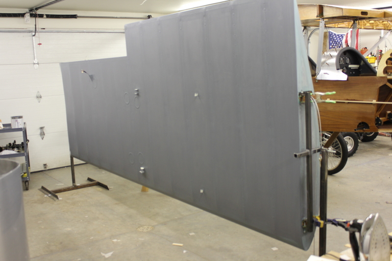

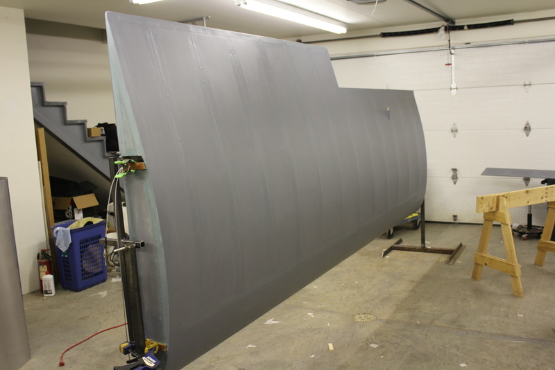

      Making some headway now one wing and the fuse to go and I'm done covering! This
      wing is primed and ready for paint

      Way to go Chris. Great looking fabric and paint work.  You'll have it at the airport
      ready to fly before you know it.

      looks great, what paint process did you use?

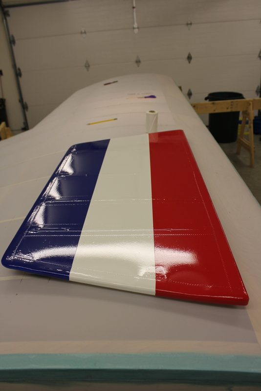

      Hey!  That's a pretty control surface -- but where is the control horn?  C

      I used automotive paint for the rudder, but I had some peeling issues when I used
      it for the flat base paint, so I am now using the new stewart systems paint.
      its a new paint not on the website yet and it seems to work very well on the
      test panels I did.

      I used the supplement plans from the UK and it will be mounted down low underneath
      the horizontal stab.....i just need to burn the holes thru. and the horns
      sandwich the rudder.
