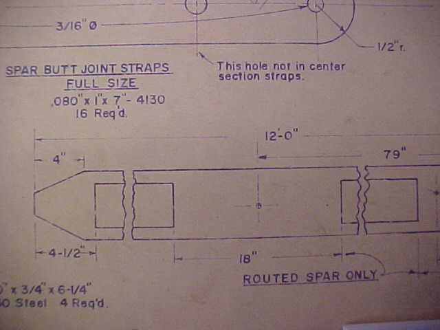

Could someone tell me the correct spar length on the Pietenpol 3 piece wing. My
drawings are saying the on the 3 piece each wing spar is 12' and the center section
is 29"? Is the 12' a misprint? The one piece wing is 14'5" each half for
total of 28'10" wing span vs 26'5" for the 3 piece? So just make the total 28'
10" with a 29" center section correct? And dis-guard the 12' measurement?

I just checked the copy of the plans that I keep on my computer (you
never know when you'll need to refer to 'em. The 'blue-line' version I
have here is a bit of photoshop so they'll look better as desktop
wallpaper.) The outer spars are 13' 2 1/2", and the center section is
29". That'll add up to 28'10".

You are correct at 28'10". That's what the 3 piece wing plans show. If
you are considering a flop or cutout to help with ingress and egress, I
recommend widening the center section to 3 feet. Bill Rewey has a drawing
of this. this makes the wingspan 29'5". Performance gain is probably
negligible, but the extra headroom is key, in my humble opinion.

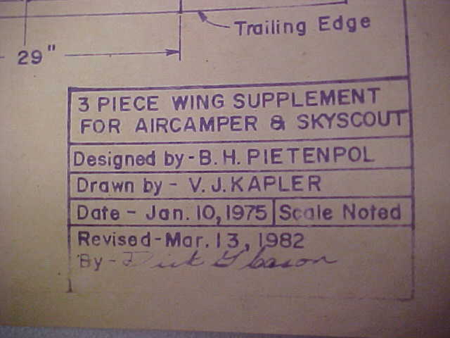

My 3-piece wing plan shows each spar to be 13 ft 2 1/2 inches. That's 158
1/2 inches. The center section spar is 29 inches. That gives a total of
346 inches for the entire wing. That's 28 ft 10 inches total. This is from
the 3-piece wing supplement dated Jan 10, 1975. Don't understand why your
plans would show different dimentions. C

Keep studying the dimensions and you will likely discover that 13' 5" makes more
sense than 13' 2.5". If you add all the bay dimensions, to include the 4.5"
tip and the 0.5" inboard stub that butts against the center section, you will
come up with 162.42"OAL, or 13' 5". I conferred with a few other builders that
came to the same conclusion.
A minor change, I know... but it appeared to make sense at the time and that is
how I cut and spaced mine.

My plans show 13' 2 1/2" and that's what I made them. So your wing is 5
inches longer than mine. Bet you can't tell the difference with the planes
parked side-by-side. Chuck

#2. The "center section" of the 1-piece wing (the plan which gives the rib
spacing) is 25 inches versus the 29 inches of the 3-piece wing. If you take
that 4 inches (2 on each wing panel) out of two of the bays the total length
of the wing comes out to be 346 inches in each case. Your wing is just
wider than the original. TSK TSK such unwarranted departure from the plans
:>) Chuck

My plans also state 13' 2.5", but I still don't see anywhere on the 3-piece plans
that indicate the rib spacing other than the center section and root ribs.
Doesn't matter so much I guess... they are built and I'm not changing them.
[Laughing]
Mark Chouinard
Wings, Center Section and Empannage and Fuse framed up - Working on Landing Gear
http://forums.matronics.com/viewtopic.php?p=387789#387789

Message 23
| Subject: | Re: 3 Piece wing spars |
Mark,
I don't have my plans at hand, so I can't check any dimensions, but... when you
wrote 162.42", did you mean 161"?
I make that same mistake all the time. :)
Bill C
Thanks for all the input! I will try and post a picture here of my plans if any
one has a idea of why they say 12'? No big deal but just makes me wonder what
else is wrong and might be a problem after alot of work is complete. These are
dated 1975, as someone had said they had but the length is different? Go figure.
I am just starting this project and have / will have many more questions
I am sure. Any advise is appreicated. Thanks
http://forums.matronics.com/viewtopic.php?p=387799#387799
http://forums.matronics.com//files/mvc_005s_139.jpg
http://forums.matronics.com//files/mvc_004s_117.jpg
Very strange. The location of the lift strut attachment isn't changed (79"), but
the length of the spar definitely is shorter. Seems like some kind of clipped
wing. Almost as though someone modified the drawing. Yet, the lettering looks
to be professionally done - not hand written. Your title block looks the
same as my print (drawn Jan 10, 1975, and revised Mar 13, 1982). The only thing
that looks different is that your print looks like a blueprint, whereas the
prints that are sold today are large-format photocopies.
Where did your plans come from?
Bill C.
http://forums.matronics.com/viewtopic.php?p=387804#387804
Does anyone else find it strange that the plans that show the weird "clipped wing"
12 ft. length are dated January of 1975 and that's the month and year that
the Steelers beat Minnesota (think 'Cherry Grove') in Superbowl IX? Or that
the revisions to those drawings are dated March of 1982 and just a few weeks before
that, Farrah Fawcett and Lee Majors were divorced? Coincidence? You decide...
(honestly, I hope somebody gets to the bottom of this because I've never seen or
heard of Piet wings that short).
Oscar Zuniga
Medford, OR
Air Camper NX41CC "Scout"
A75 power
http://forums.matronics.com/viewtopic.php?p=387821#387821
