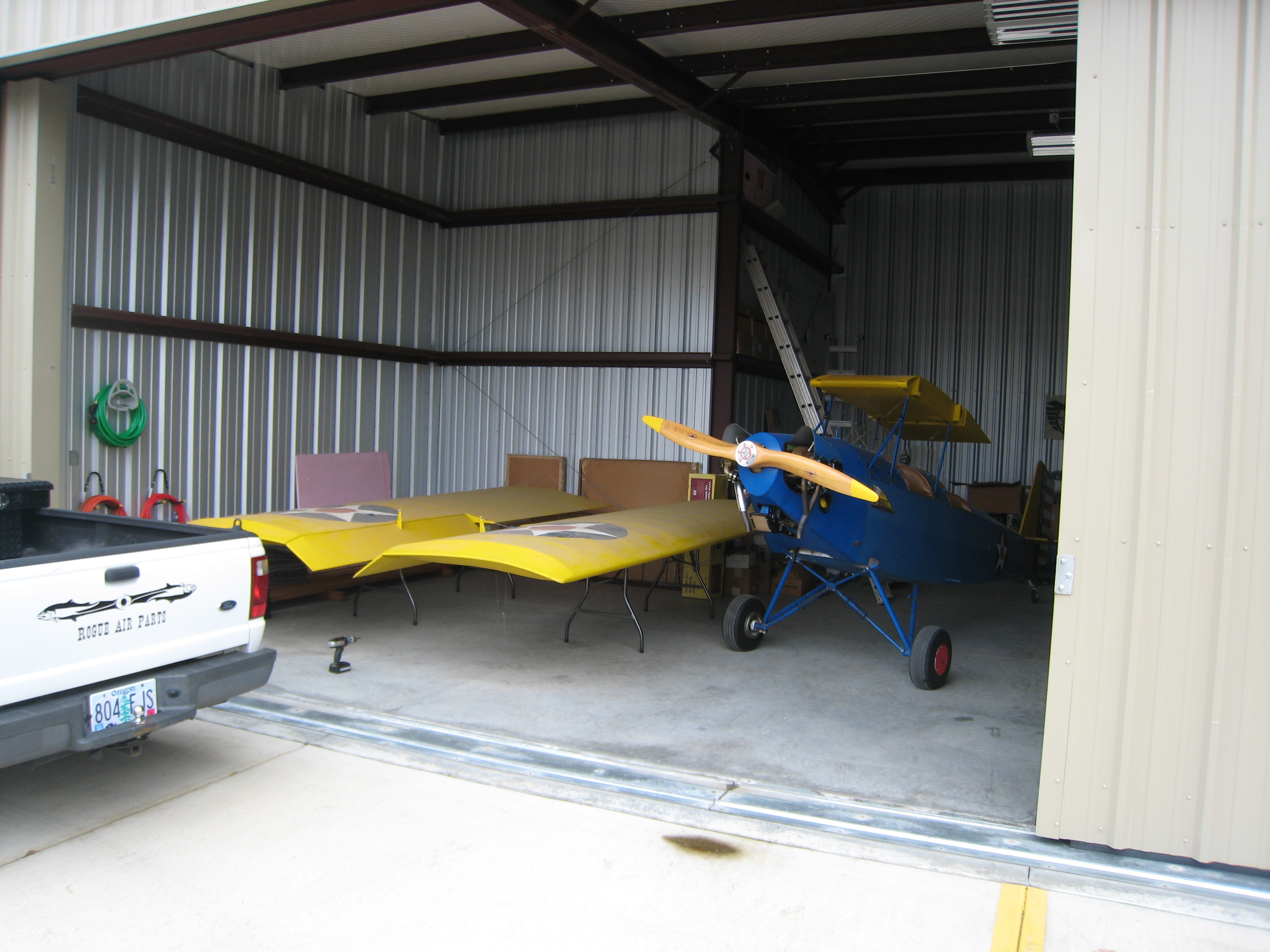

Just one last shot on this thread and I'll move on. Here's a picture of Scout
in the new hangar. Actually, only one hangar door is open in this shot (the Zenith
project is behind the other door). LOTS of Texas hangar dust on the tops
of the wings! I have the new cooling eyebrows to install, a little bit of maintenance
to do here and there before annual condition inspection, and one thing
that I'm going to fix for good is the front seat support. My rudder bar stops
have dislodged the vertical front seat support plywood twice now, breaking
glue joints, so I'm going to put down a crosspiece to secure the bottom of the
support to the plywood floor, glued and screwed.
When wearing bulky shoes or boots while flying, it is almost impossible to fully
deflect the rudder bar without pushing the front seat upright plywood forward.
Anybody else ever had to reattach the lower edge of the front seat plywood?
