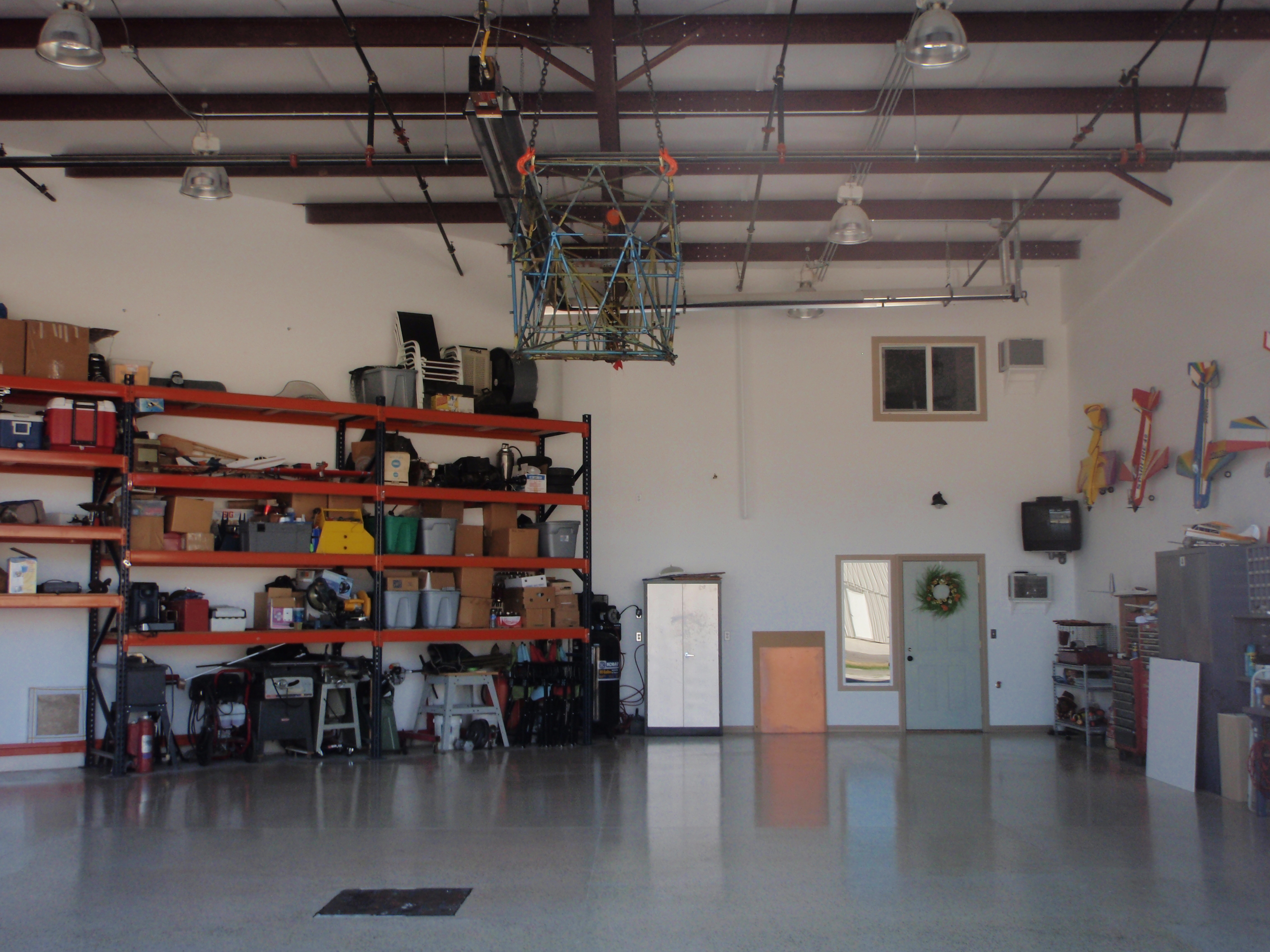

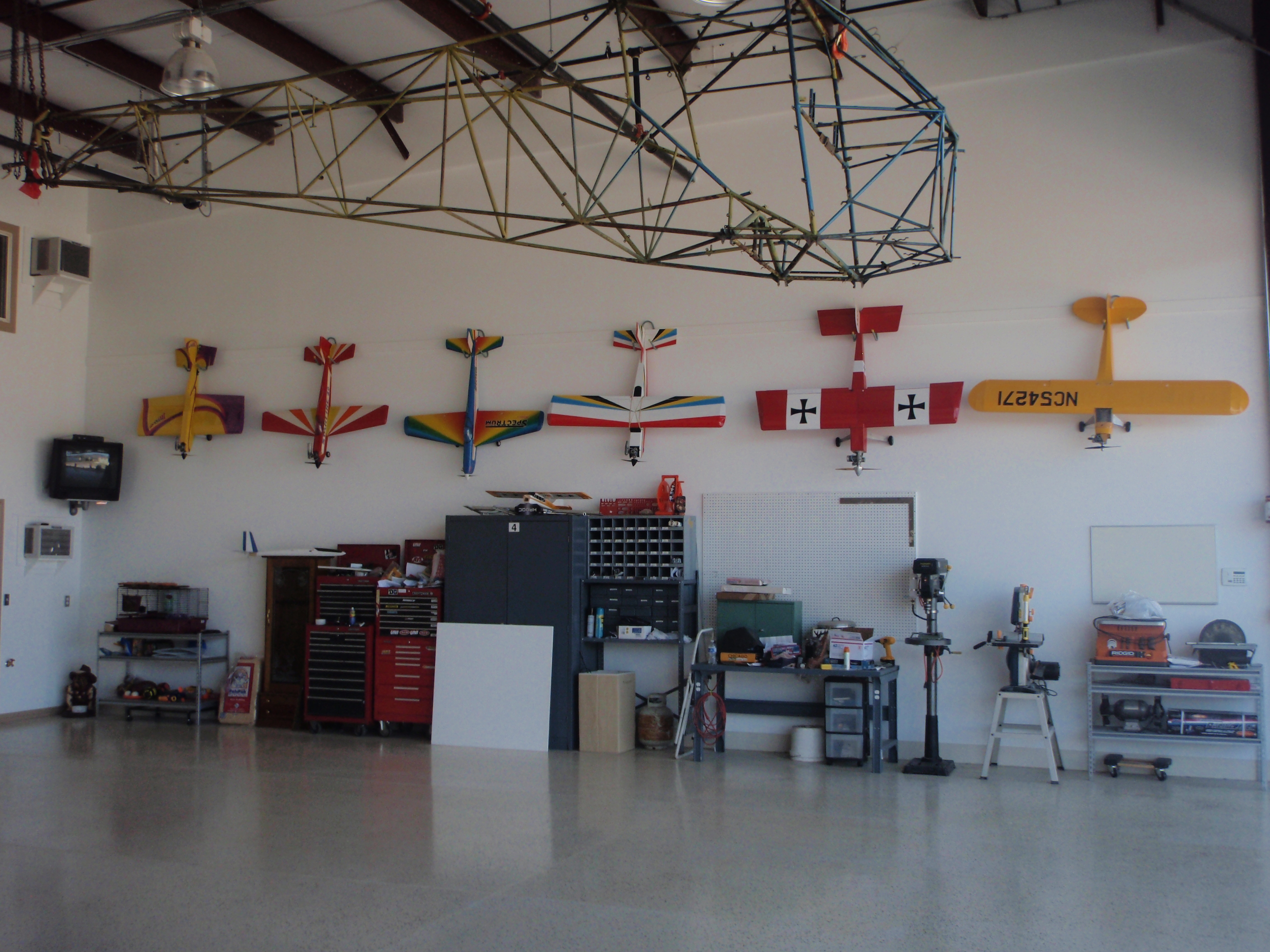

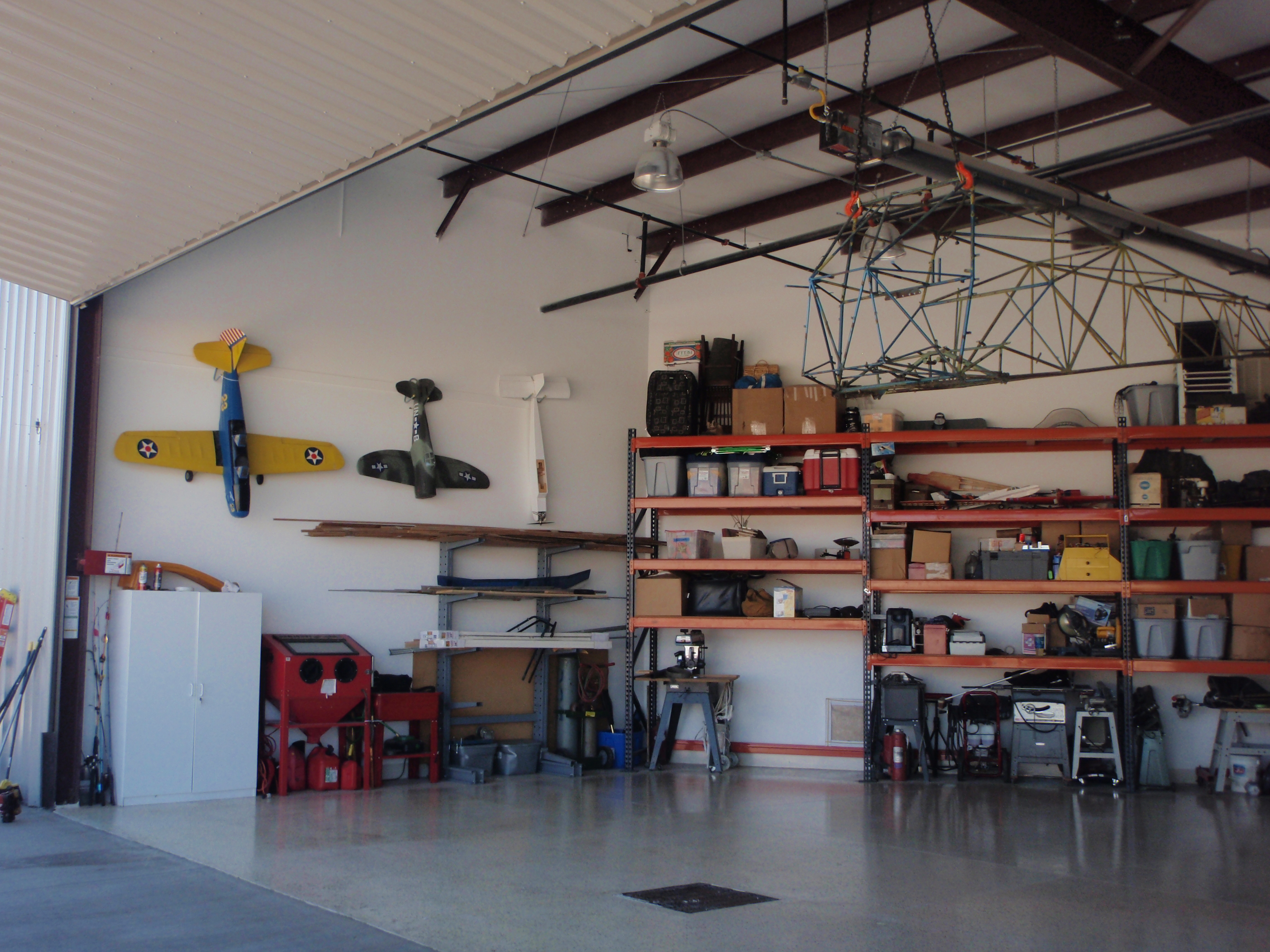

Could I get some hangar advice? I have bought a hangar in a new set of hangars
that will be constructed this spring.
It will be 40 x 32 with side folding doors. Nothing fancy, just a hangar. It will
have one elect box and one plugin, It will also have water run to it. We are
working on a septic plan. Pipes will be laid for that.
I will be like many guys. My hangar will be worth more than my plane.
Any advice on what to do? IE fans, work space, electricity, sealing doors, etc?
Blue Skies,

Steve, I bought and had built a new hangar about four years ago. It
was the best thing to happen for my Pietenpol project in a long, long
time. A couple of things I figured out after I had mine built.
Lights and electrical outlets. You can't have too much light or too
many outlets.
Also, I don't recall where you live, but that may influence your
decisions. We are in a part of the country that can get quite a lot of
snow (though not this year). The snow seems to melt away much more
quickly on the east-facing side of the hangar, which fortunately is
the side with my door. Also as the snow melts, it tends to slough off
the roof and refreeze into a berm on the ground alongside the
west-side of the hangar. That berm acts as a dam, such that any
snowmelt dripping off the roof has only one place to go -- under the
hangar wall and across the hangar floor. The solution has been a
gutter on the west side of the hangar and religious attention to the
removal of the snow berm as it begins to form.
Finally, a heater and insulation. I haven't insulated my hangar yet.
In retrospect, I wish I had done that before I started filling the
hangar with all kinds of stuff. I do have installed a 220 volt barn
heater that can raise the temperature about 20 degrees above the
outside temperature in the portion of the hangar that serves as my
work area. With insulation, the heater would no doubt be far more
effective. As it is, I'm wasting heat and not getting as much as I'd
like.
Best of luck with yours and congratulations, Ken

Having a hangar in Texas the best feature is proper insultation to keep the
summer heat out.=0ASecondly door or windows oposing the main hangar door t
o get cross flow cooling by opening them up.=0AFans as back up, I use small
portable fans, but planning to build a large ceiling fan.=0A-=0ASeal the
doors-to keep critters and snakes out.=0A-=0AThe rest depends on-wha
t you use your hangar for, storing aircraft or building one.=0A-=0AIf you
build one, -you never have enough power outlets, have 4 on each wall and
still not enough.=0ACompressed air system with proper 220V Compressor=0AMo
re Lights, specially above work space.=0A-=0AOther must haves:=0AChairs t
o sit on=0AFridge to keep the Beer cool=0ABBQ to burn some meat=0A-=0AHav
e fun=0A-=0AHans=0ANX15KV- =0A=0A________________________________=0A Fr
om: "Dortch, Steven D MAJ MIL USA NGB" <steven.d.dortch@us.army.mil>=0ATo:
pietenpol-list@matronics.com =0ASent: Thursday, December 6, 2012 9:57 AM=0A
Subject: Pietenpol-List: buying a hangar=0A =0A--> Pietenpol-List message
posted by: "Dortch, Steven D MAJ MIL USA NGB" <steven.d.dortch@us.army.mil>
=0A=0A=0ACould I get some hangar advice? I have bought a hangar in a new se
t of hangars that will be constructed this spring. =0AIt will be 40 x 32 wi
th side folding doors. Nothing fancy, just a hangar. It will have one elect
box and one plugin, It will also have water run to it. We are working on a
septic plan. Pipes will be laid for that. =0A=0AI will be like many guys.
My hangar will be worth more than my plane. =0A=0AAny advice on what to do?
IE fans, work space, electricity, sealing doors, etc? =0A=0ABlue Skies,=0A

Steve;
You saw what Randy, Craig, and I had at 8T8. I echo most of the sentiments from
the others, and emphasize the following, if you'll only be there during fun
times and not spending whole days at a time:
-we always got grass clippings, dust, and driving rain in under the hangar doors
until we installed some hanging-down carpet strips on the bottom of the doors.
We kept some long boards handy, "weather boards", to anchor the strips to
the floor when driving storms were expected from the direction of the hangar doors.
You don't want water in your hangar.
-the hangars that adjoined ours didn't have any protection from driving rain in
under the doors of their hangars, so if it got into their hangars, it got into
ours. Good insurance to find discarded pallets to stack stuff on in case water
gets in. Water is not good for most things that we keep in hangars.
-you will never have enough plugs. I had a 25 ft. cord reel that I never installed
but it would have been very, very handy. You always need power around the
hangar.
-go vertical with stuff. Most hangars have high walls and ceilings, so go vertical
or you'll waste all the volume in the upper reaches of your hangar.
-Randy applied a nice garage floor coating on the hangar floor when he got it,
and it is great to always have a durable, clean, attractive floor. The Lowe's
type stuff goes on pretty easy. If the floor is handsome, you'll tend to keep
the place cleaner.
-you can never have too much light in a hangar, but it will never be in the right
place ;o)
Oscar Zuniga
