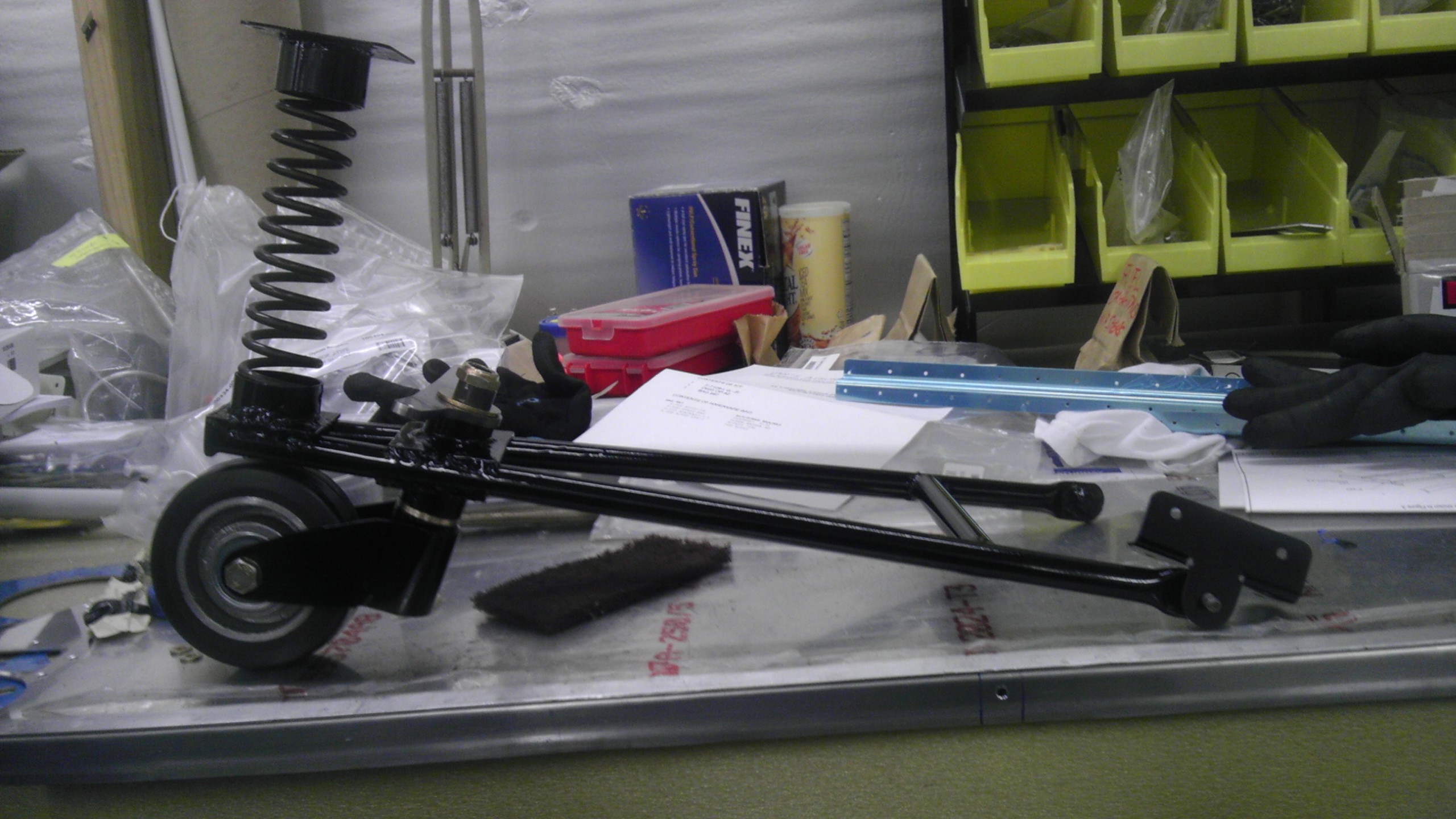

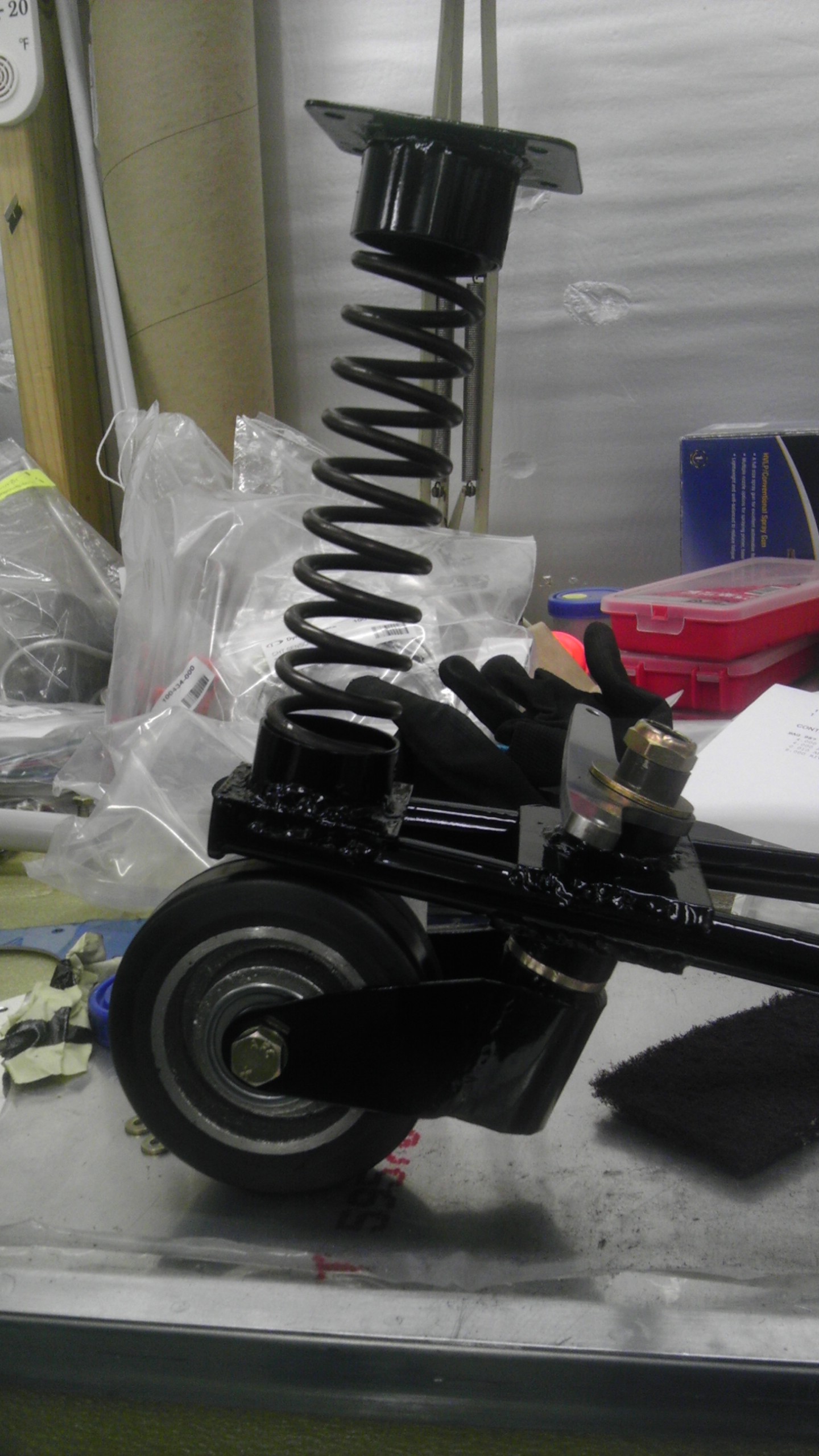

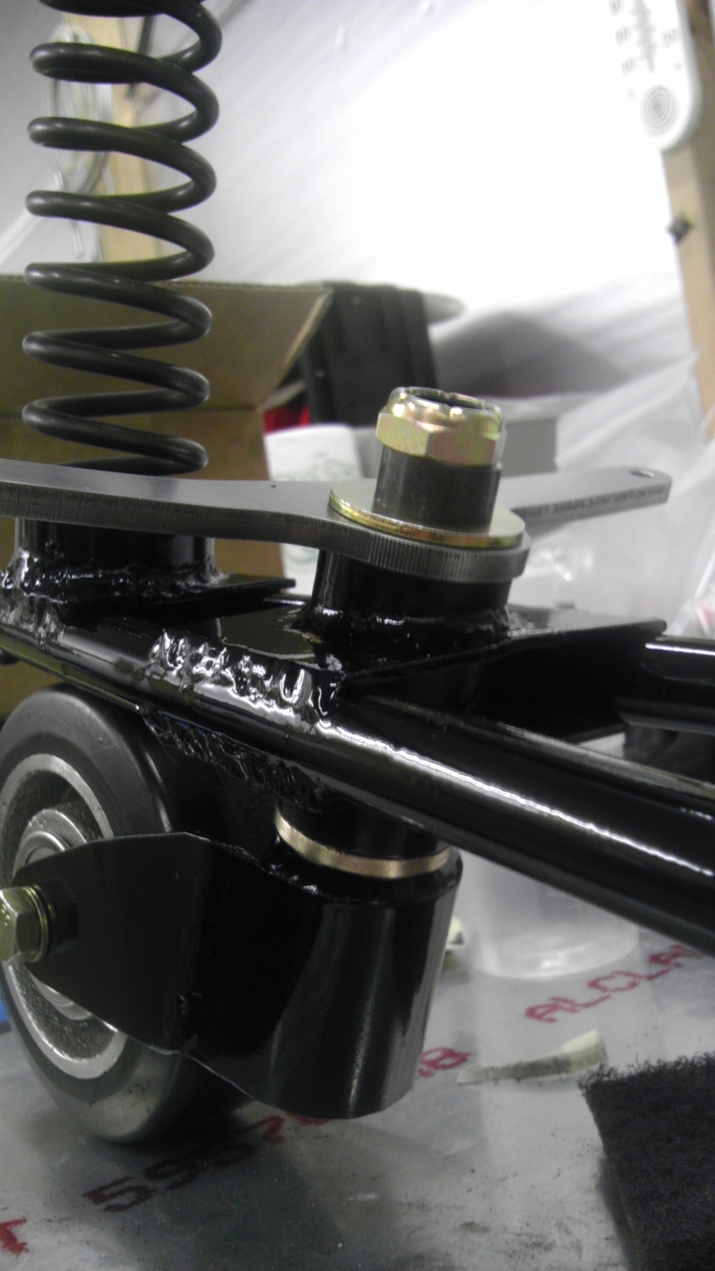

Attached are a couple pictures of our finished tail wheel. Originally I bought
a Matco wheel because dad and I both wanted to have a steerable tail wheel that
also has a break free mechanism, but we also wanted more to go with the original
design. I returned the Matco and we purchased an RV setup from Vans for
a reasonable 140.00. After a few small modifications we now have what we see
as the best of both worlds. A steerable tail wheel with a break free mechanism
that is built from the plans. It is a very simple modification (I am speaking
for my father because he "designed the modification" if that makes sense, while
I was and still am busy with the birth of my son). Anyway if anybody is interested
in this idea we have part numbers from Vans and Dad made a drawings of
the modifications that need to be made.
P.S. Has anybody heard from Chris Tracy? We have been trying to reach him to see
if he would want to post our pictures to his website?
Fred Kim
Pittsburgh, Pa
