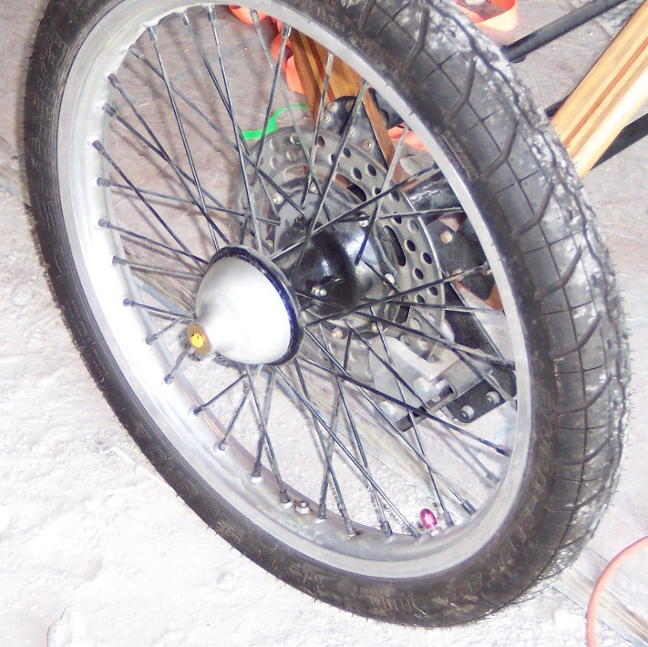

Jack my mechanical brakes hold real good. I used Carlisle calipers. The wheels
and brake discs are Kawasaki Motocross 21". With plenty of heel pressure they
can hold for a full power run-up. The diameter of the disc + mechanical advantage
+ brake pad area + wheel diameter = brake performance. With the wheels and
discs and calipers I had no idea how much mechanical advantage to build into
the pedals. I just built TLAR and as luck goes it worked!
