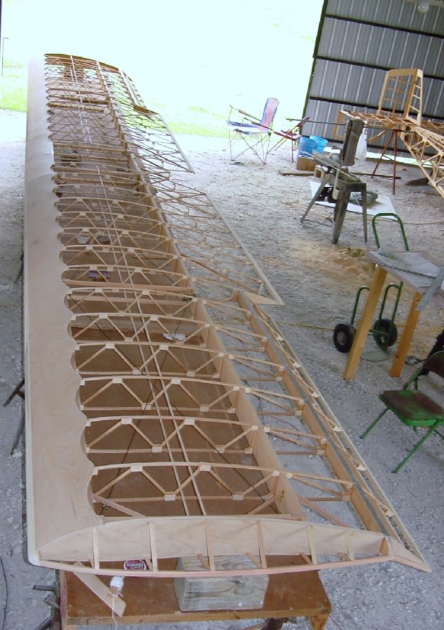

| Subject: | Re: 3 piece wing 1 wing weight |
Mario I used all sitka spruce and faa approved plywood in the wing. I used full
1 inch thick spars with no routing. It was so big and hard to turn. If doing
it again I would make the 3 piece wing.

Message 5
What a wing!!!! beautiful job Jerry
I can not do something so big.. just one looks giant ;o)
I see the plywood cover in the leadin edge is cut in U between ribs.. why? why
not stright?

Message 6
I thought it would look good cut that way. The only way to see it is on a ladder
