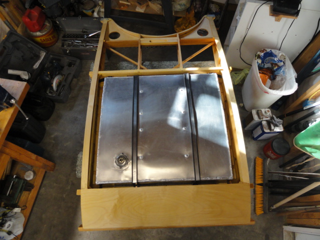

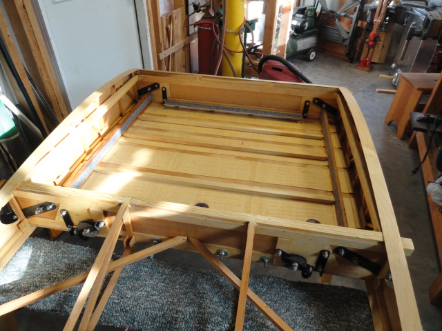

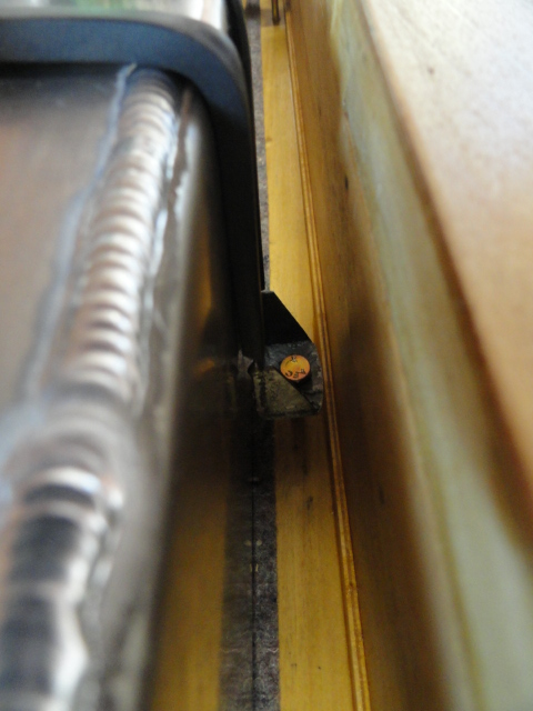

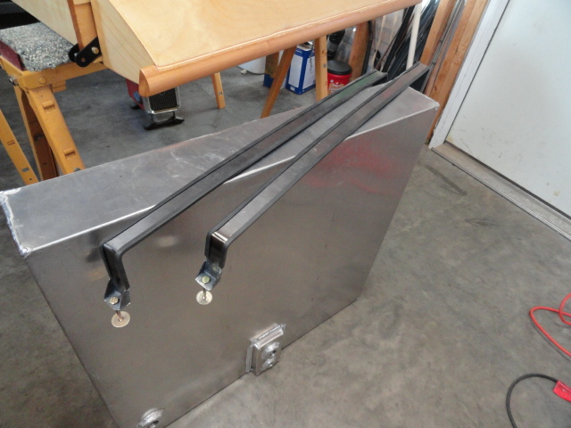

      In the spirit of Christmas, my tank mounting went as follows.  I have a 3 ft. center
      section as per Bill Rewey.  My tank is welded aluminum with 15 gal. cap.
      I purchased from ACS the rubber anti-chafe channel that fits a 1 in. steel strap.
      Bought 72 in. lenths and cut in half resulting in two 36 in. straps.  I
      bent the straps around the tank, fore and aft, and bent the ends 90 deg. and
      welded on gussets, drilled and bolted thru the ledgers that are secured to the
      lower portion of the spars and support the tank.  Pics attached.
      Robert Caldwell
