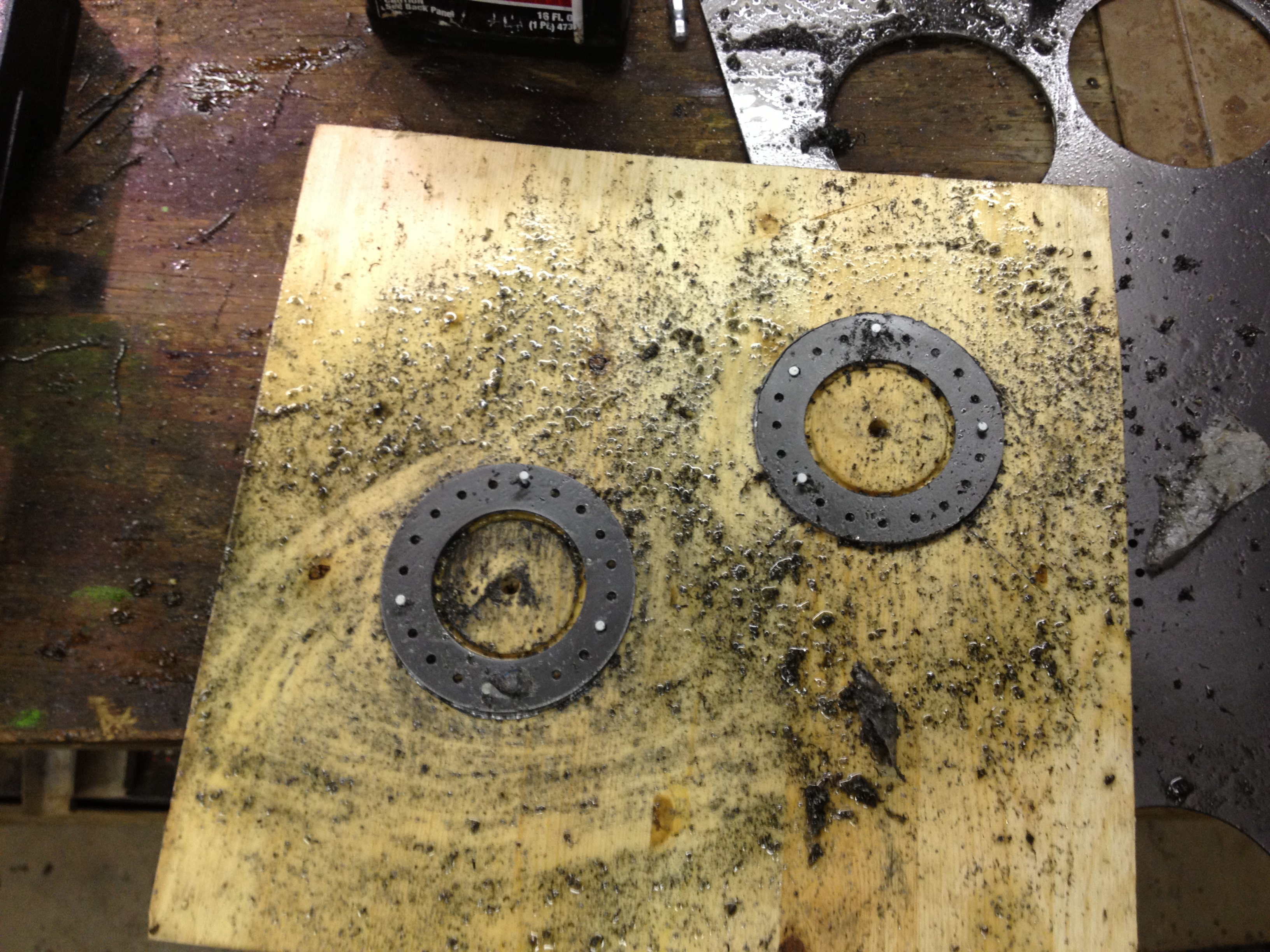

Had my brother sketch this up. Tape a copy to a piece of metal and center punch
on the X's. I used a 3.5' hole saw for the outside diameter and 2' for the center.
PDF file bottom of last picture.
