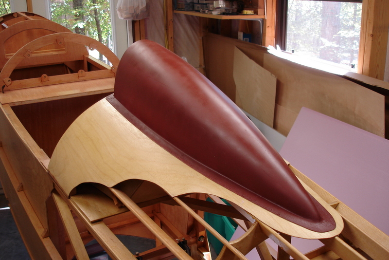

      Ray Krause asked me about the headrest I have fabricated, so I thought I would
      start a new topic for it.  First, I built my turtle deck about 2" higher than
      the drawing call for.  Because I really like the look of the headrest I decided
      to add one.  I applied a base of 1/16" ply on the turtle deck as an attachment
      point for the headrest.  I roughed out the shape and size and made a plug or
      form to lay up the fiber glass. The plug is made from laminated construction
      foam sheet.  Laminations glued together with 3M spray adhesive.  I added a 1/4"
      ply sheet to the front of the plug for attaching a foam cushion.  I used clear
      packing tape as a mold release.  (Can't say enough about having the Bingelis
      books as how-to's)  I wanted a flange around the base of the headrest in order
      to facilitate attaching to the deck.  I left the foam plug inside the fiber
      glass shell after completing it for additional stiffness and strength.  It added
      very little weight.  The shell was smoothed with sanding and filler and primed.
      As yet the headrest is not permanently attached, but I think T88 will
      do the trick and when covered with the Ceconite, all will blend well.  Pics attached.
      Robert Caldwell
