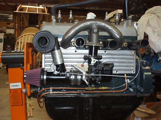

Although I fabricated a carb-heat system for my Model-A engine, I have not operated
it at high RPM enough to answer your question. What I have experienced at
low to mid-range RPMs was slight to no RPM change. Ive been planning on using
a remote laser-thermometer to check temps at the muff, air duct and carburetor
throat to see what the temperature changes might be.
Gene I hadnt heard about the air filter restriction before and will have to play
with that also when I get back to the project. Thanks!
http://forums.matronics.com/viewtopic.php?p=392532#392532
http://forums.matronics.com//files/p6080010_180.jpg
