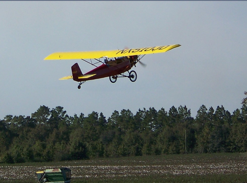

      PF Beck and Don Harper need some attaboys for their efforts. I applaud you.
      Now my Piet would not be a good one to compare.
      32 1/2 foot one piece wing BP airfoil
      Lycoming O-235 C2C 115 hp @ 2800 but it never sees over 2500 so it actually puts
      out around 100 hp
      CloudCars prop 76 X 44
      Performance figures .... not real scientific!
       Top speed 105 and was still climbing. I'm dumb but not that dumb. It was
        waay too fast for me.
      Top cruise @ 2450  90 or a little better. I only did that for a test. Still way
      too fast.
      I normally cruise about 2000 and get 70-72. If I get in a hurry 2200 gets 80
      Climb is around 900 to 1000 feet per minute but I never use that for long.
      When I get above the trees good I throttle back and climb @ 70
      Stall is around 40 or 42. I was expecting 35 but not to be.
      All these non-scientific tests were done at a gross weight of 1150 to 1160. The
      speed checks were
      done 2 directions with a Garmin GPS. (except for top speed it was indicated)
      Jerry Dotson
      First flight June 16,2012
      Started building July, 2009
      Lycoming O-235 C2C
      Jay Anderson CloudCars prop 76 X 44
      http://forums.matronics.com/viewtopic.php?p=393559#393559

      lookin good Jerry! Love that deck angle.
