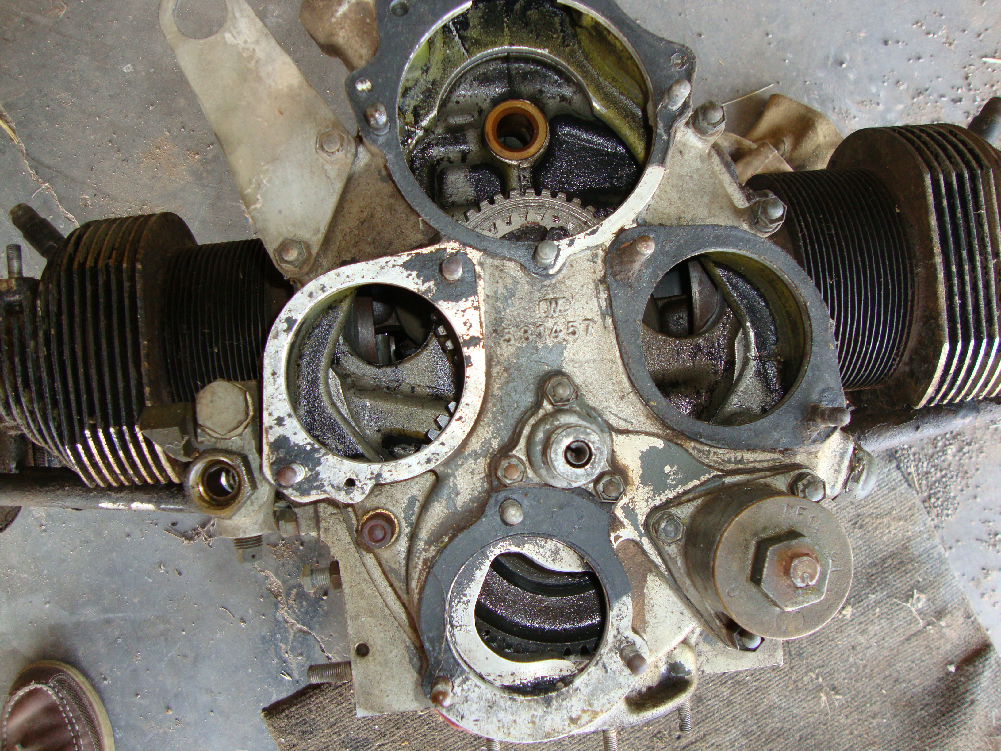

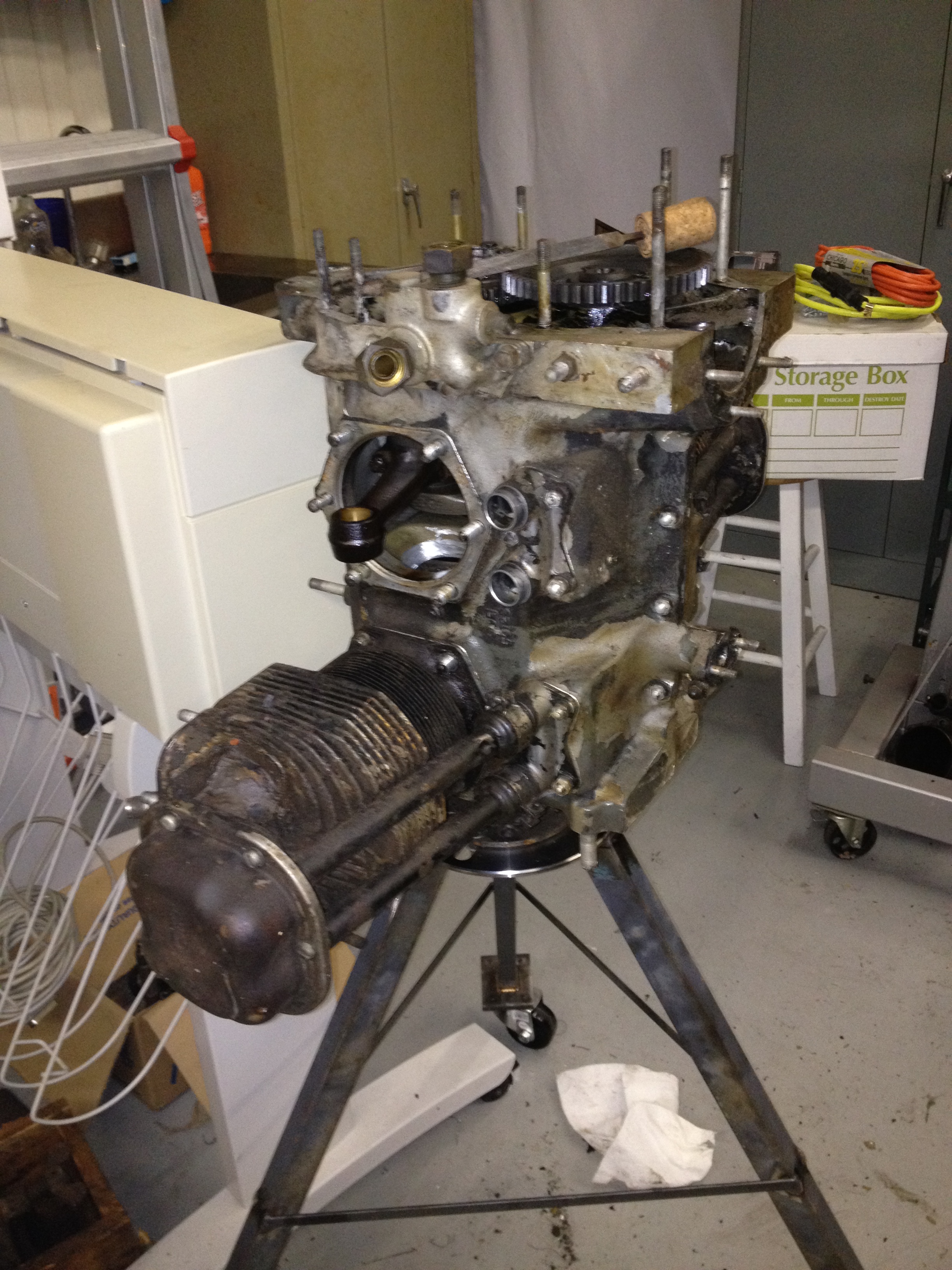

A few months back, a buddy of mine sold me a Continental PC-60 Packette engine,
which is virtually identical to a C-90, at least inside. Along with the PC-60,
I got a C-85-12F Crankcase and four O-200 Chrome plated Cylinders, with valves...
all for $250. Then, on another visit, I found second GPU engine which
I picked up for $50. The thought was that I would be able to put together one
nice C-90-ish engine in a C-85 case. Since the GPU is a -12 configuration,
the gears, and accessory case will allow me to have a full up electrical system.
(I fly from a controlled field where they train air traffic controllers, and
they don't like aircraft without radio & xponder.)
So, during the last couple of weeks, I built an engine stand, mounted the engine,
and tore it down. Pics are attached.
After disassembly, the crankshaft mikes mid-range of NEW specs on both main and
rod journals, and the only thing it needs is magnafluxing.
The Cam, followers, & oil pump are all within tolerance and pristine in appearance.
The pistons, however, are a different story, as they appear to be used,
with a few broken rings, and ring grooves beyond the wear limits.
Next, I'll vat the C-85 case and start getting bearings to build the lower end.
If any of you have C-85 or 90 parts you want to offload, contact me offline and
let me know what you have. I'd really like to find a 530788 cam, and a set of
pistons...
one nice C-90-ish engine in a C-85 case. Since the GPU is a -12 configuration,
and they don't like aircraft without radio & xponder.)
of pistons...

Gardiner,
WOW! That's great... I'll take both!
Please call me at 832-326-2970, and we'll make arrangements to pay and ship.
Tom
