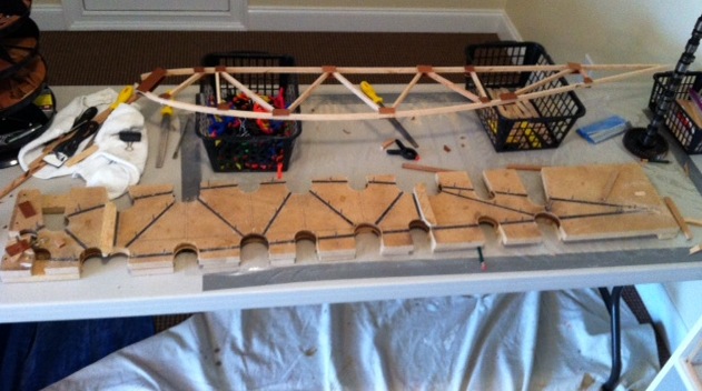

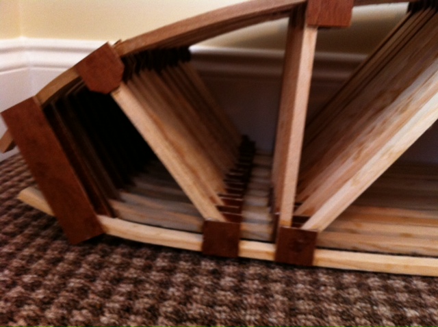

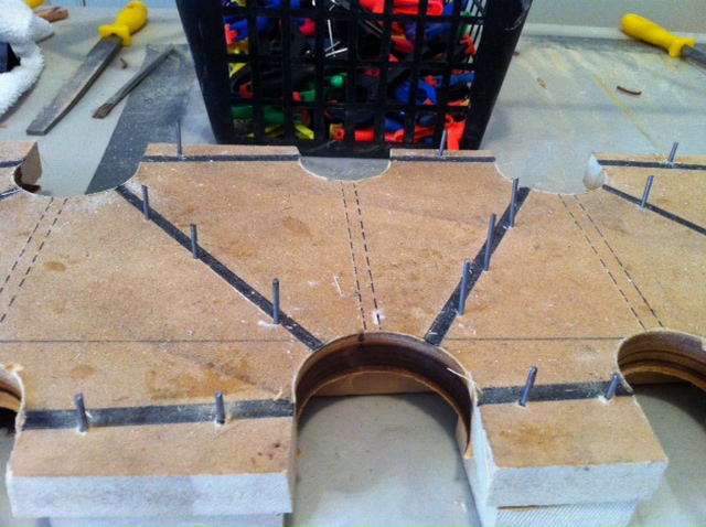

So here is how I have been bending my cap strips. You can see my fancy
steamer. It is a cheapo, Walmart teapot, with the whistler removed. In its
place I stuck a length of PVC pipe with some JB Weld to (sort of) seal the
joint. I just heated it and boiled/steamed the cap strips for about an hour.
I then put them in the cap strip jig made from a 4X4 post. I paid a cabinet
shop $10.00 to cut the post to the arc that I marked. Why? Because they had
a much better band saw than I did and could cut the jig much more accurately
than I could. I like the way that the nose of the cap strip fits securely in
the slot, and then all I need are a couple clamps to hold things overnight.
It ain't rocket science, and I hope that I motivate someone to get started
on their wing ribs.
P.S. I loaded the pictures in the order I wanted, but they came out
backwards. So "the last shall be first, and the first shall be last." You
get thi idea.
Also, in case you are wondering what the holes in the cap strip jig are for,
they were my initial idea that I could use plastic ties to hold the cap
strips. Bad Idea. can't pull the ties tight enough. Clamps work better. Not
all ideas are good ones!

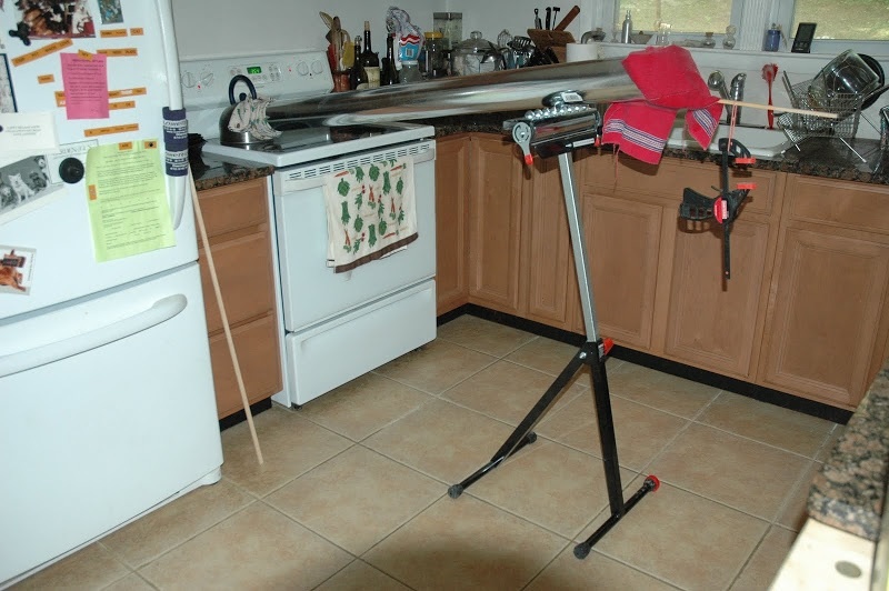

I have the Riblett 612 and soaked my cap strip in cold water for about an h
our.- The PVC pipe could hold a bunch of strip, but my pre-bend jig could
only hold about four at a time.
My strips are all sitka spruce and I had no bending or breaking problems. I
only pre-bent the top strips, I did not pre-bend...nor soak, the bottom st
rips.

Pretty much how I did it- nothing fancy!
Didn't have as good results soaking
Earl Brown

Message 17
| Subject: | So Now What Do You Do With Them There Bent Strips? |
As I said in my previous posting, there are some fine wood workers in this group.
And I have seen some really fine wing rib jigs. Some with clamps, some with
Dowels used to lock the verticals in place. I have seen discussions about the
pluses and minuses of staples, nails, clamps, all of the above, and none of
the above.
So, after designing my wing rib jig for the THIRD time, I settled on the following.
I used MDF, and nails with the heads cut off (got that from one of Tony Bingelis'
articles and I liked the simplicity). I used the MDF, A sharpie to mark
the wing rib outline, some nails, some pieces of wood to go where the spars
will sit, and three tubes of clamps from Harbor Freight. Oh, and of course, T88.
I cut holes at the joints and cut a notch so I could use clamps instead of
staples or nails. Mine may go down as the ugliest jig ever presented on this
forum, but I have included pictures of the end result in order to show you that
the ribs match up quite well. And no staples or nails. The ribs hopefully once
covered will not be seen for another 10-15 years or more, so I am not concerned
that they are not works of art. I can tell you, however, that they are strong
as can be.
I am sure you are wondering how I am going to take care of the gussets extending
past the edge of the cap strips. I plan to either carefully use my trusty bandsaw
to remove the "proud " portion, or my router table with a flush bit. Any
suggestions are gladly accepted.
Again, I just want some people to see that the beauty of the jig is not what makes
strong ribs. It is the quality of the rest of the work. Even if you are not
a master woodworker, you can build this airplane, so GET STARTED!
Semper Fi,
Terry Hand
Athens, GA
http://forums.matronics.com/viewtopic.php?p=394907#394907

Message 18
| Subject: | Re: So Now What Do You Do With Them There Bent Strips? |
Take a look at a power file. Ryobi and Black and Decker make one. I use the
m all the time working on spas. =0A=0AThe belts come in all sorts of grits.
Variable speed.=0A=0AThey are also good at smoothing metal etc. =0A=0AThey
will make a nicely rounded radius quick smart. =0A=0A=0A=0A=0A____________
____________________=0A From: jarheadpilot82 <jarheadpilot82@hotmail.com>
=0ATo: pietenpol-list@matronics.com =0ASent: Sunday, February 24, 2013 3:41
PM=0ASubject: Pietenpol-List: So Now What Do You Do With Them There Bent S
dpilot82@hotmail.com>=0A=0AAs I said in my previous posting, there are some
fine wood workers in this group. And I have seen some really fine wing rib
jigs. Some with clamps, some with Dowels used to lock the verticals in pla
ce. I have seen discussions about- the pluses and minuses of staples, nai
ls, clamps, all of the above, and none of the above. =0A=0ASo, after design
ing my wing rib jig for the THIRD time, I settled on the following. I used
articles and I liked the simplicity). I used the MDF, A sharpie to mark the
wing rib outline, some nails, some pieces of wood to go where the spars wi
88. I cut holes at the joints and cut a notch so I could use clamps instead
of staples or nails. Mine may go down as the ugliest jig ever presented on
this forum, but I have included pictures of the end result in order to sho
w you that the ribs match up quite well. And no staples or nails. The ribs
hopefully once covered will not be seen for another 10-15 years or more, so
I am not concerned that they are not works of art. I can tell you, however
, that they are strong as can be.=0A=0AI am sure you are wondering how I am
going to take care of the gussets extending past the edge of the cap strip
s. I plan to either carefully use my trusty bandsaw to remove the "proud "
portion, or my router table with a flush bit. Any suggestions are gladly ac
cepted.=0A=0AAgain, I just want some people to see that the beauty of the j
ig is not what makes strong ribs. It is the quality of the rest of the work
. Even if you are not a master woodworker, you can build this airplane, so
GET STARTED!=0A=0A--------=0ASemper Fi,=0A=0ATerry Hand=0AAthens, GA=0A=0A
=0A=0A=0ARead this topic online here:=0A=0Ahttp://forums.matronics.com/view
topic.php?p=394907#394907=0A=0A=0A=0A=0AAttachments: =0A=0Ahttp://forums.
matronics.com//files/posting_1_261.jpg=0Ahttp://forums.matronics.com//files
/posting_2_667.jpg=0Ahttp://forums.matronics.com//files/posting_3_247.jpg
=0Ahttp://forums.matronics.com//files/posting_3a_716.jpg=0Ahttp://forums.ma
tronics.com//files/posting_4_212.jpg=0Ahttp://forums.matronics.com//files/p
osting_5_181.jpg=0Ahttp://forums.matronics.com//files/posting_6_159.jpg=0Ah
Message 19
Thanks, George, I will check on it.
Semper Fi,
Terry Hand
Athens, GA
http://forums.matronics.com/viewtopic.php?p=394909#394909
Message 20
Hi Terry
Taxi on down to the Chinese Hardware Store (aka Harbor Freight) and get one of
their bench-mounted belt sanders like 97181 ($79 on sale NOW), then take that
silly guard off. You now have a VERY useful device for dressing all manor of
material, from the little bits of plywood on ribs to smoothing the edges of 4130
after cutting. Almost any similar belt sander will do. I have no great love
for HF. The one thing to consider is the ability to take off the "guard" so
you have a flat, unencumbered belt to put the larger stuff (like ribs) on.

Hey Terry!
Nice looking jig!
Search for laminate trimmer router bits. They're a flush cutting router bit with
an end mounted bearing. Will work easiest in a router table, will have to
run around one side and then flip over, but will go REALLY fast and effective.
For the discerning craftsman, some of then will even put in a slight bevel...
Designed to cut counter top laminates flush.
http://forums.matronics.com/viewtopic.php?p=394911#394911
Message 22
That is one great jig. How many of the rest of us
were smart enough to make a jig that allows
installing the gussets on BOTH sides at the same
time?? Well, I didn't! :-)
I just passed my ribs across my disc sander to
get rid of the proud bits. Regardless of what
you use just remember that just because you
stop moving the machine doesn't! And don't
worry about glue squeeze out. Just spread it
out on the wood. You have to seal it anyway.
Clif
Everything should be made as simple as possible,
but not simpler. Einstein
. Mine may go down as the ugliest jig ever presented on this forum, but I
have included pictures of the end result in order to show you that the ribs
match up quite well. > I am sure you are wondering how I am going to take
care of the gussets extending past the edge of the cap strips. I plan to
either carefully use my trusty bandsaw to remove the "proud " portion, or my
router table with a flush bit. Any suggestions are gladly accepted.
> Semper Fi,
> Terry Hand
> Athens, GA
