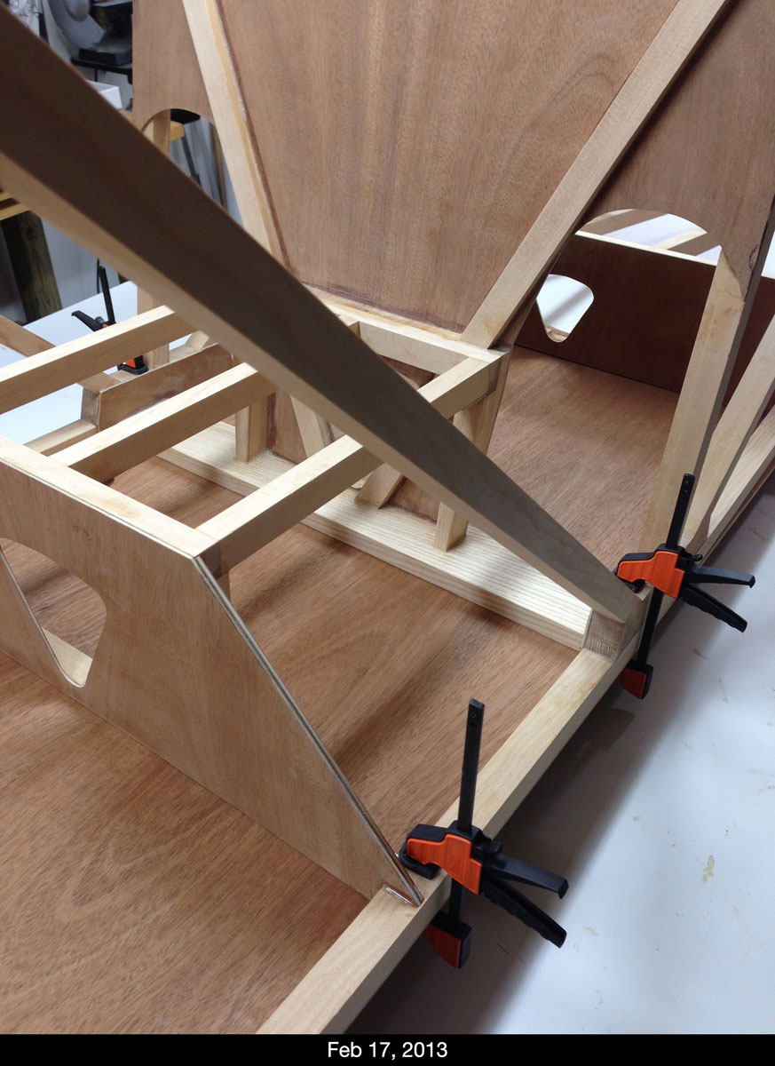

      Hello All-
      This list has been a great help for info and motivation to me over the past few
      years- so, since i was updating my build photos today- thought i would post a
      couple-
      maybe help some others with some motivation!
      here is the address to the albums on Picasa if anyone wants to take a look at the
      whole story so far!
      https://picasaweb.google.com/105058930661974974244
      Earl Brown
      I may not have gone where I intended to go, but I think I have ended up where I
      intended to be.

      Gorgeous work, Earl!  I don't think mine was ever that clean.

      Nice, Earl! Be sure to send something to www.westcoastpiet.com.

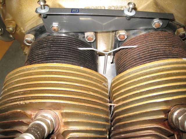

      I was out at the hangar and took a couple of pictures of the baffles on my A75.
      One shot from the underside and one from above.
      Oscar Zuniga
      Medford, OR
      Air Camper NX41CC "Scout"
      A75 power
