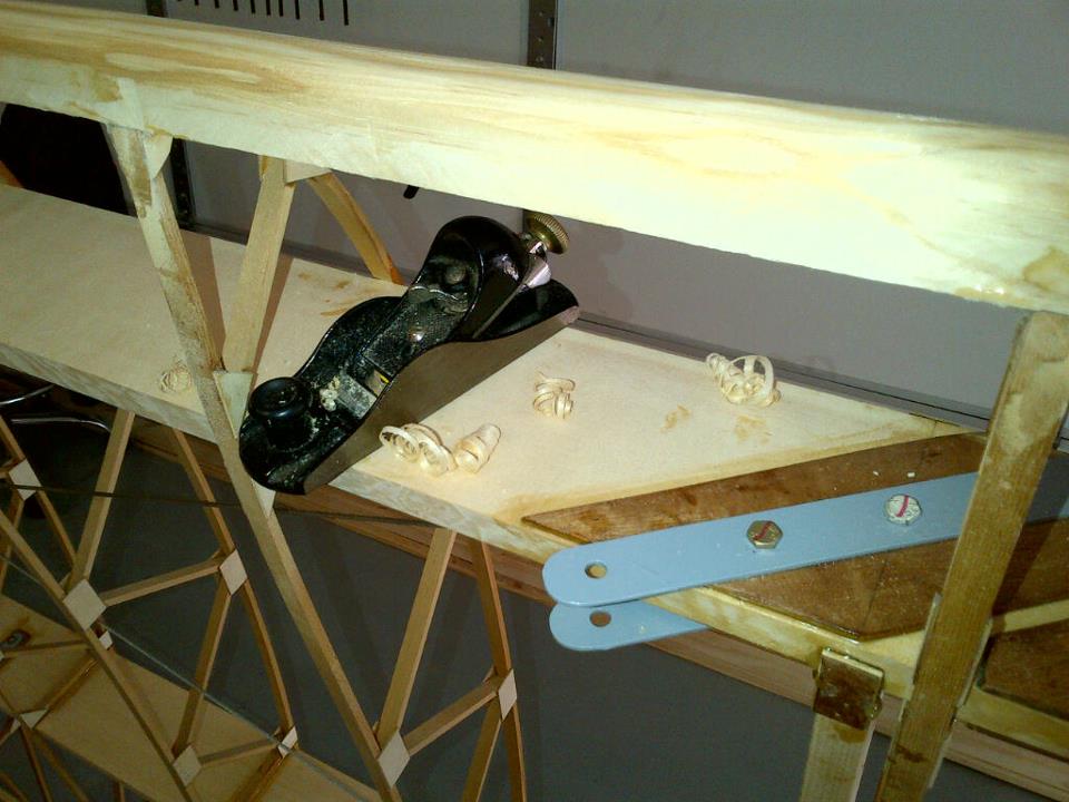

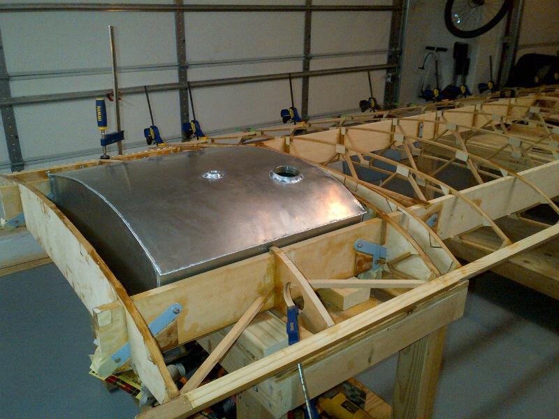

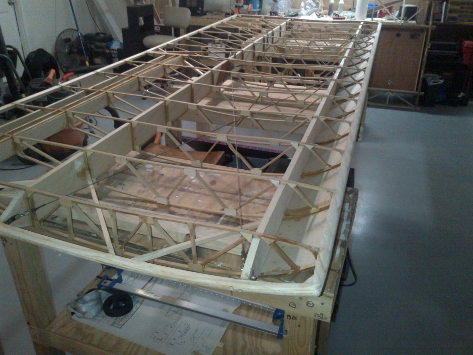

Message 8
      Tail surfaces are repaired.  Engine ran at Corvair College 24 in South Carolina
      in November.  Fuel tank is complete.  Left wing panel woodwork is complete.
      Framing up right wing now.
      I've recovered to pretty near 100% - flying for work and pleasure, running, etc.
      I'll miss Brodhead, Gardiner.  I've got work obligations and, frankly, Shelley
      & I are about to get furloughed during the sequester.  That's a big chunk of income.
      Breaks my heart to miss Brodhead.  Really wanted to see everyone and wanted to
      have the chance to talk to people about the accident.  I did a thorough write-up
      for the BPA newsletter, though.  I think Doc will publish that in April.  That'll
      have to suffice until 2014.
      Kevin "Axel" Purtee
      Rebuilding NX899KP
      Austin/San Marcos, TX
      http://forums.matronics.com/viewtopic.php?p=395695#395695
