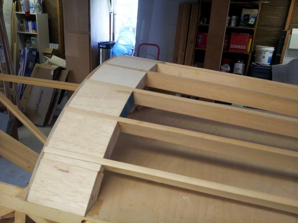

Message 11
      That's very nice work Mark-
      On the wood and the metal
      Earl Brown
      I may not have gone where I intended to go, but I think I have ended up where I

Message 17
      Thanks guys! The welding is much easier and more fun than I had imagined!
      http://forums.matronics.com/viewtopic.php?p=398056#398056

Message 23
| Subject:  | Do I need to sheet this with plywood? |
      Hey Guys:
      Do I need to sheet this with plywood? I used balsa blocks to fill the space between
      the top.deck stringers as bracing. It goes back about 4" back from the
      face of the front of the top former/sear back. I was planning to cover this with
      1/8 ply, but after looking at the final product, I am thinking it is plenty
      strong, but I am not sure how much abuse this part gets when sitting on it/ getting
      in and out/ etc.
      Will the final covering be enough if I cover the top with some leather like Mike
      Cuy? Just looking for some "been there, done that" advice.
      I do plan to "dimple" or feather the edges to prevent the covering from having
      a hard edge regardless...
      Thanks!
      http://forums.matronics.com/viewtopic.php?p=398076#398076
      http://forums.matronics.com//files/13653632089300_134.jpg

Message 25
      I recommend plywood, either 1/8" or 1/16"...just ties it all together.
      Gary Boothe
      NX308MB

Message 30
| Subject:  | Re: Do I need to sheet this with plywood? |
      Use plywood. 1/16 is fine. Ties it all together (where did I hear this?)
      Dan Helsper
      Puryear, TN
      -----Original Message-----
      From: Gary Boothe <gboothe5@comcast.net>
      Sent: Sun, Apr 7, 2013 2:57 pm
      Subject: RE: Pietenpol-List: Do I need to sheet this with plywood?
      Okie Doakie... I will make a ply skirt for it.  Thanks for the advice!
      http://forums.matronics.com/viewtopic.php?p=398097#398097
      The balsa blocking is probably strong enough, although it might dent easily.
      I covered this area with 1/16" birch plywood, per the picture below:
      Jack Phillips
      NX899JP
      Smith Mountain Lake, Virginia
