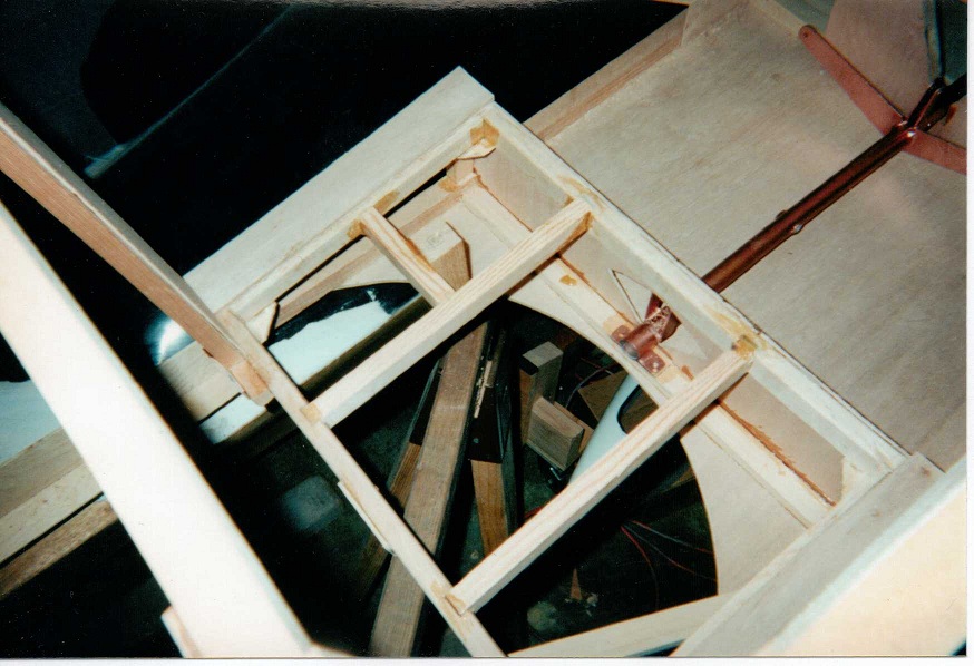

I filled with balsa and covered in 1/32 ply.
My rudder cables go in a straight line from
the bar to the rudder. In doing so they lie
just above the front edge of the seat. I acquired
a 1/4" thick piece of micarta ( traditional you know )
and made guides from that. At the seat back they
do only that, no direction change at all. The
ones mounted above the bellcrank do bend
a teeny weeny bit, barely noticable in the pic.
Another thing I've added is rudder stops at
the bar. At full deflection they hold said
rudder 1/2" away from the elevators. I saw a
vid once of completion inspection and that
was a fail on that plane so I checked mine
and sure enough the rudder went too far. Not
any more. :-)

> Hey Guys:
> Do I need to sheet this with plywood? I used balsa blocks to fill the
> space between the top.deck stringers as bracing. It goes back about 4"
> back from the face of the front of the top former/sear back. I was
> planning to cover this with 1/8 ply, but after looking at the final
> product, I am thinking it is plenty strong, but I am not sure how much
> abuse this part gets when sitting on it/ getting in and out/ etc.
> Will the final covering be enough if I cover the top with some leather
> like Mike Cuy? Just looking for some "been there, done that" advice.
> I do plan to "dimple" or feather the edges to prevent the covering from
> having a hard edge regardless...
> Thanks!

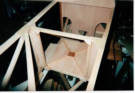

Mark:
I can't get to a photo right now but I did run my cables through the wood cross
member as shown on the plan. I did modify that slightly by drilling a hole in
the center of a delrin rod (from ACS) and make fairleads from that they were
inserted into the wood cross member. The holes in the delrin were ramped on
the ends to act more like a slick bearing surface to protect the cables as they
changed direction. They seem to work very well and the cables do not bind at
all. -Disclaimer- this modification has not experienced flight yet.
Tom Stinemetze
McPherson, Kansas
N328X
>>> "Mark Roberts" <mark.rbrts1@gmail.com> 4/6/2013 10:26 PM >>>
Seeings as how we all want to make Mr. Pietenpol's airplane just "that much better"
than he designed it, I am wondering how many of you have opted for running
the 1/8" elevator cables through the seat bottom cross brace as shown on the
plans, or used pulleys as I have felt inclined to do. I see a few pics from the
guys that have used pulleys, but don't remember seeing any where they drilled
holes as shown on the plans through the rear seat bottom cross member.

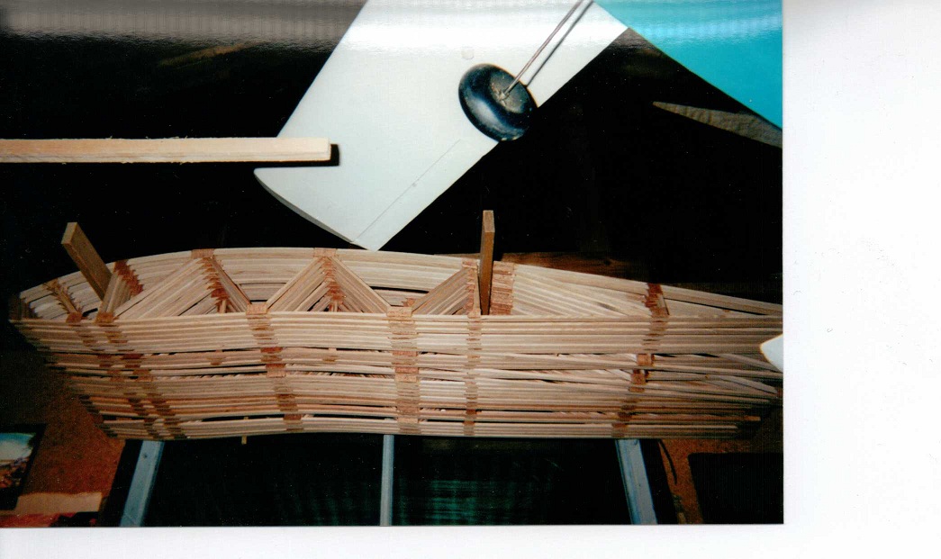

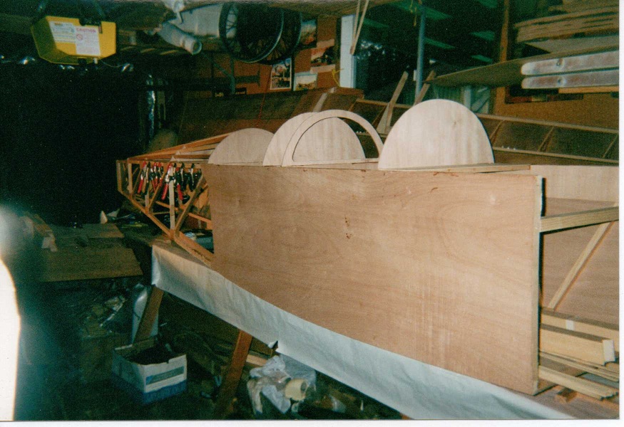

I have been scanning photos into my computer so here are a few of my new air camper
components so far. On the fuselage I have since adding the side plywood and
am currently working on my wood gear cleaning up the smoke damage and preparing
my old hardware for reuse. I will be dismantling my wire wheels and adding
grease cups, I think I will leave uncovered this time around. I need to purchase
a new Axel since my old one is bowed noticeably.
http://forums.matronics.com/viewtopic.php?p=398188#398188
