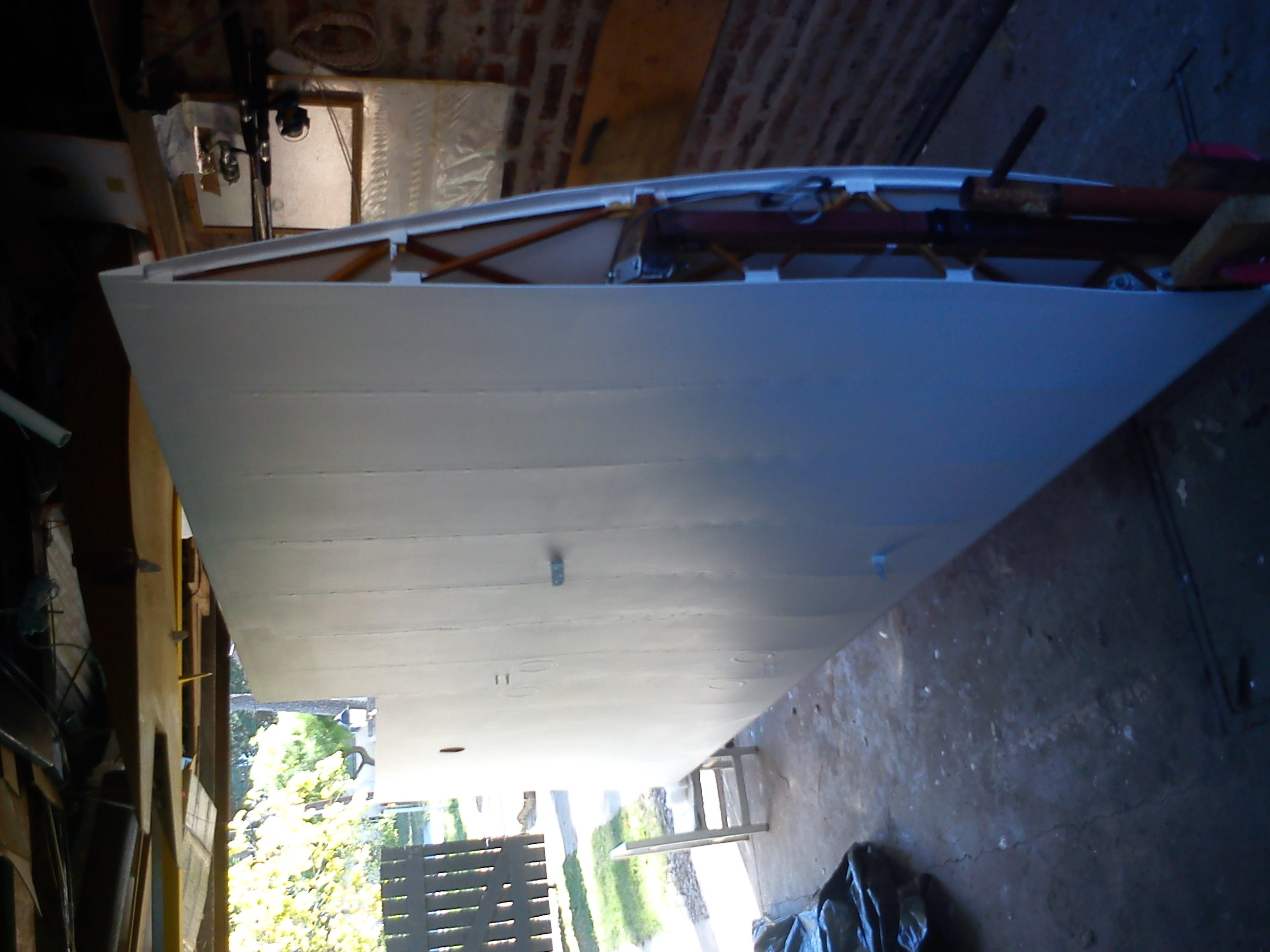

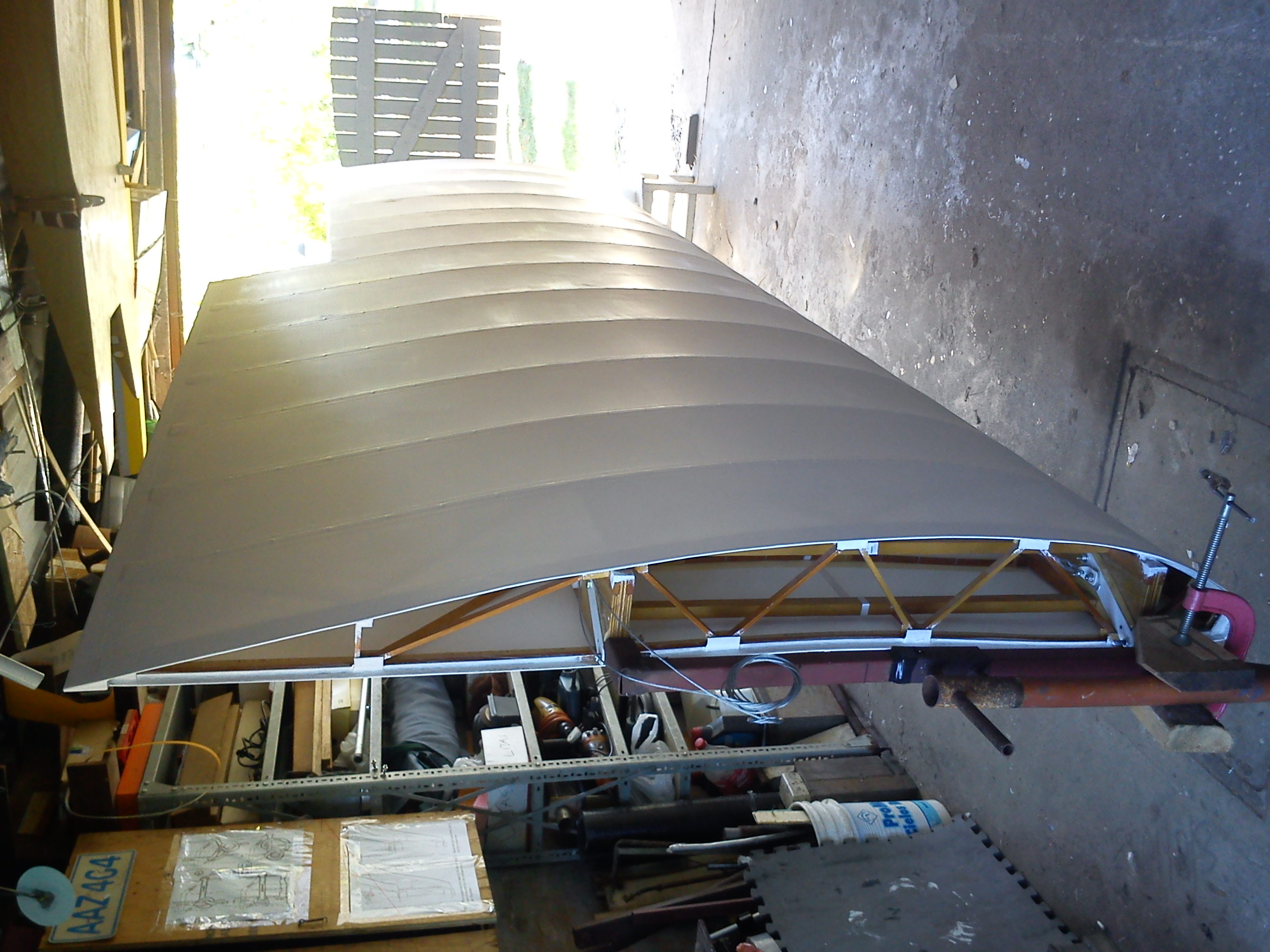

Hello,
I have finish my first wing. I paint it with latex, it have by the moment 4 ( 1
Gal) hands of paint, I plan 2 or 3 more but in yellow. Inspections rings, cables,
evrything in it place.
Some photos here http://goo.gl/zAl1L

I have read quite a bit on the latex paint process folks are using and just
wanted to mention that I used flat black latex as an undercoat and Rodda P
olyurethane floor paint as the top coat applied with small foam rollers and
the results where impressive. Craig

> Hello=2C
> I have finish my first wing. I paint it with latex=2C it have by the mome
nt 4 ( 1 Gal) hands of paint=2C I plan 2 or 3 more but in yellow. Inspectio
ns rings=2C cables=2C evrything in it place.

Outstanding Mario!

Hello,
( 1 Gal) hands of paint, I plan 2 or 3 more but in yellow. Inspections
rings, cables, evrything in it place.
Mario Giacummo
Photos here: http://goo.gl/wh7M4
Little Blog : http://vgmk1.blogspot.com
