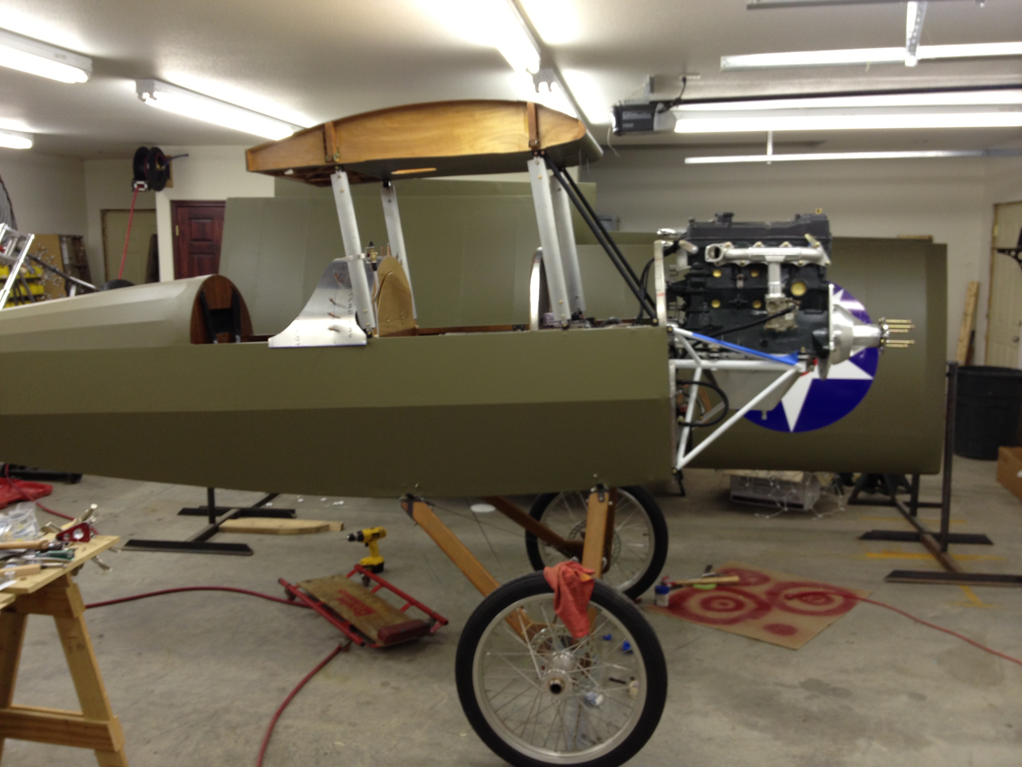

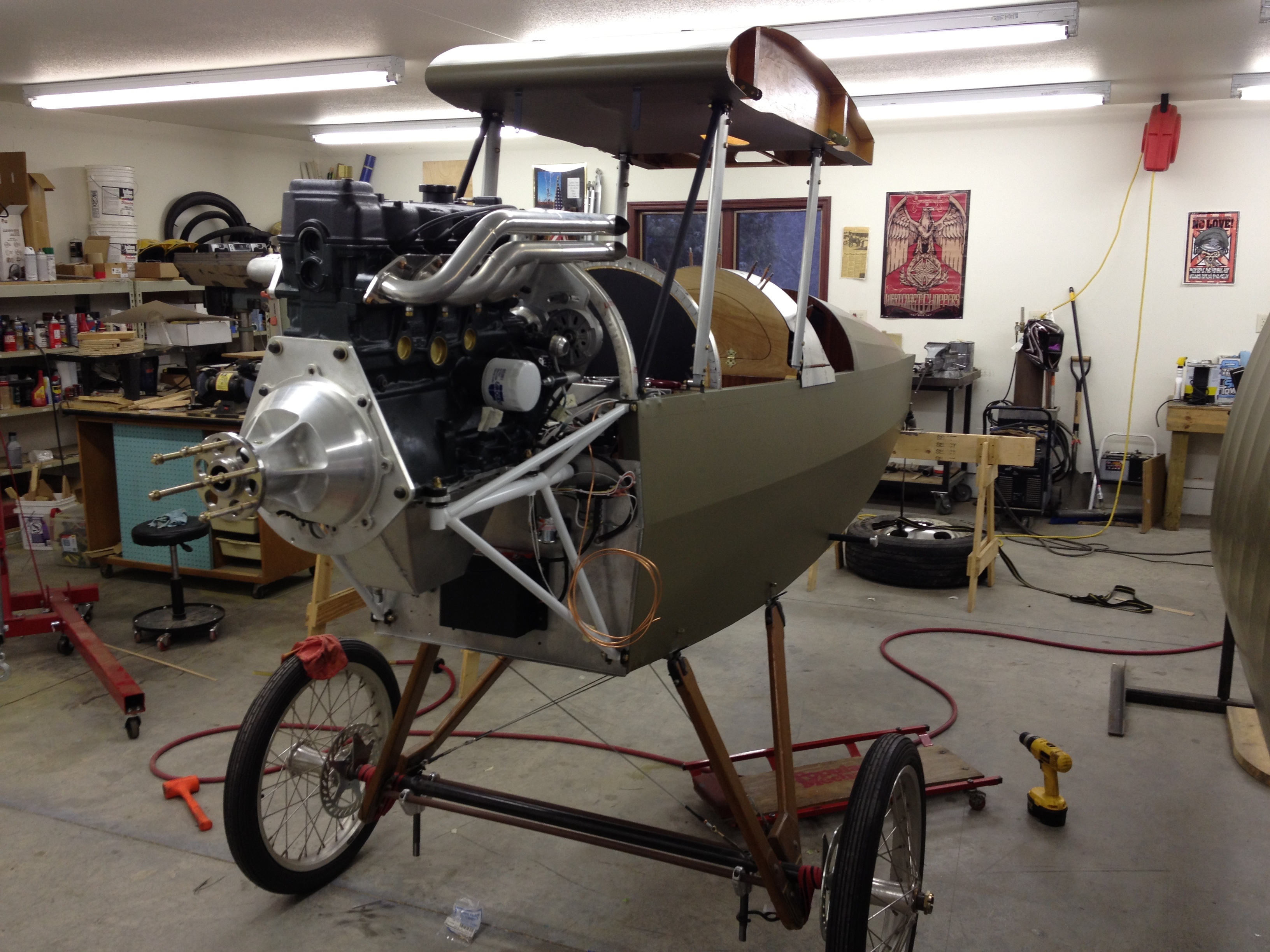

      Everything is going back together nicely..... It's really exciting now
      NX321LR
      Fully Assembled
      Tail assembly and ailerons covered and painted.
      Wings covered and primed, one painted
      Mitsubishi Powered
      http://forums.matronics.com/viewtopic.php?p=398506#398506

      Chris---what a gorgeous looking airplane you have there!     You're the first one
      with the olive drab US Army Air Corps
      paint scheme that I've seen and it looks great.   Your workmanship looks to be
      first class.  Thank you for sharing some photos.
      Will your radiator for your Mitsubishi engine be in the traditional Ford A location?
      Looks like you've adopted or fabricated a gear reduction drive up front.   Are
      they using these engine in other homebuilts that
      you know of?
      Great to see your progress!

      Thanks! I have to say this site has been a huge inspiration to keep pushing forward,
      i look forward to seeing what everybody is up to and how everyone else solves
      the issues that come up.
      Nobody has used this engine to my knowledge, it my modern version of a model "A"......well
      see, remember its  "Experimental Aviation"
      The unit up front is a external bearing hub with isolator bushings between the
      crank and prop, hopefully removing all of the torsional vibration as well as thrust
      loads. This unit also houses the starter ring..Im using a harley davidson
      starter and ring gear, spinns it over like butter.
      I know Jack is painting his a similar green, so i cant wait to see them both together.

      Wow this is awesome=2C man look at the creativity involved=2C the clever an
      ti torque setup and the nice wheels=2C very interesting engine setup=2C the
       color you chose=2C wow. Ok I need to calm down a bit I'm not the young any
      more. Man I have got to get over to Broadhead only I worry the excitment mi
      ght kill me.:) Craig
