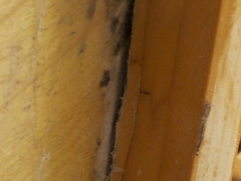

      It wasn't as bad as I thought it would be to cut it out. The little cutting tool
      I have did a nice job. The chisels did the rest, and then the cutter helped
      "sand" down the epoxy to the wood. I am using West systems epoxy, and it works
      very well. Mixed in with some cab-o-sil and it makes a strong, gap filling bond.
      Next step: cut a new member and glue it in...
      Upon inspection of the piece when removed, the compression fracture wasn't all
      the way through the whole width of the strut, but still, in the back of your mind,
      it was always gonna be there. This repair is so simple it was a no brainier.
      Thanks again for the advice! Here's some pics of the process.
