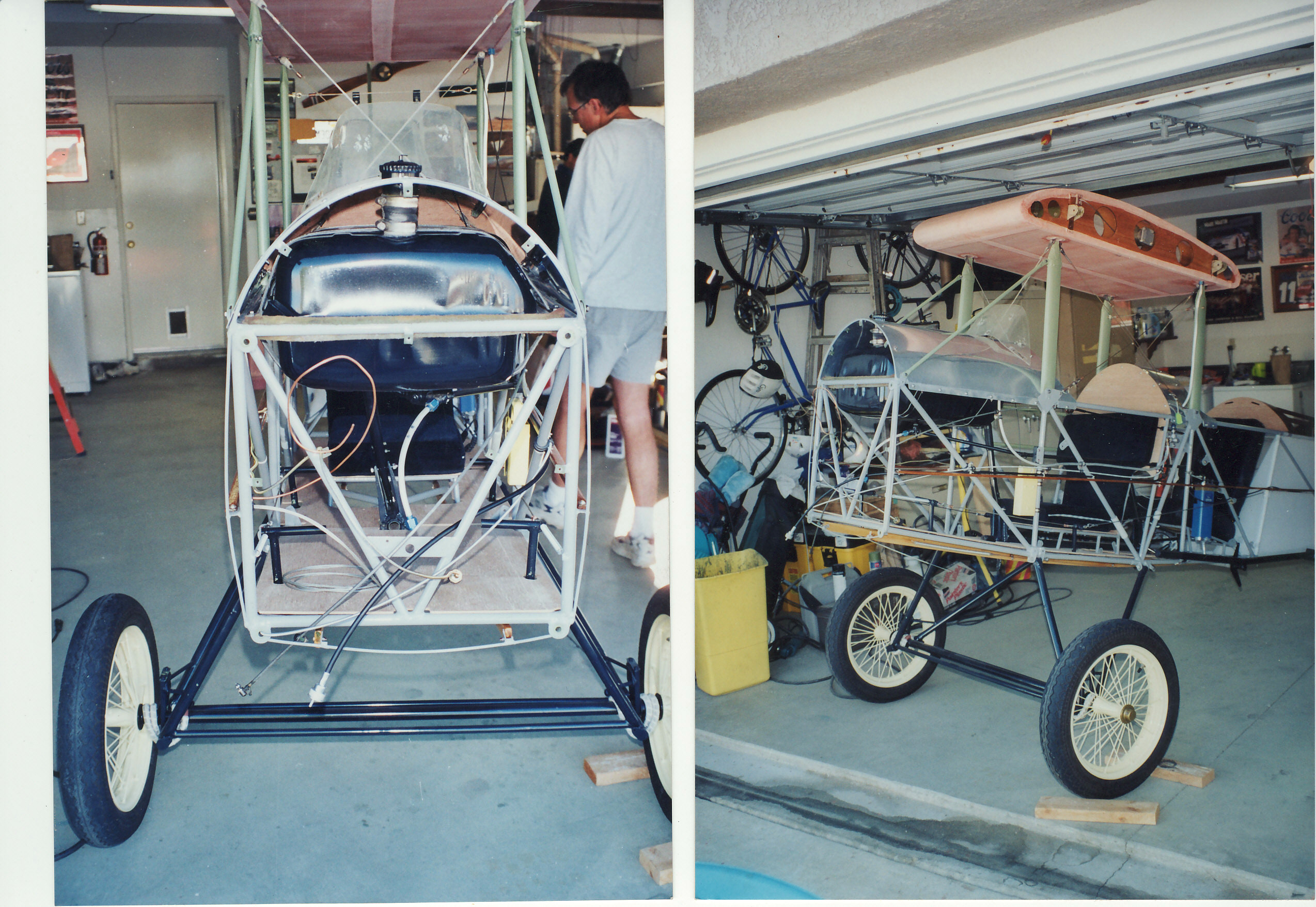

Here is a pic of my planes front view. The axle is 1.5 inches by 0.125 wall and
is original to the plane. It does not have anything extra in the center of it.
At times I do have a little bow in the axle when loaded to gross weight.
I do not have any brakes which means that the axle is full floating and can rotate
should a wheel run low on grease. Ask me how I know. It is hard on the
bungee cords when that happens. My feeling is to just use the heavier wall tube
and don't worry about it. When it does bend or flex a little it add some camber
to the wheels. I think that would make for a little better handling qualities.
My 3 cents. (adjusted for inflation)
