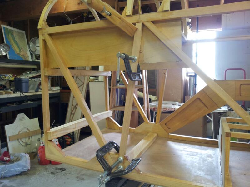

| Subject:  | Re: Well, I did it... Cut out that compression fracture |
      Now it's fixed!
      http://forums.matronics.com/viewtopic.php?p=400389#400389
      http://forums.matronics.com//files/13683195156930_799.jpg
