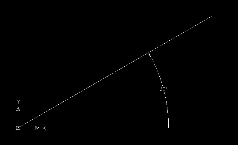

| Subject: | Re: fuel flow test |
Rick,
Look at what 20 degrees looks like when you get it set, and I think that you will
agree that you are unlikely to pitch the nose up that high on a regular basis,
so 20 should work just fine.
people don't realize that 25-30 degrees looks like about 45 degrees when simply
looking outside. It is just not a pitch attitude you will see much of.
Semper Fi,
Terry Hand
Athens, GA
http://forums.matronics.com/viewtopic.php?p=401291#401291
