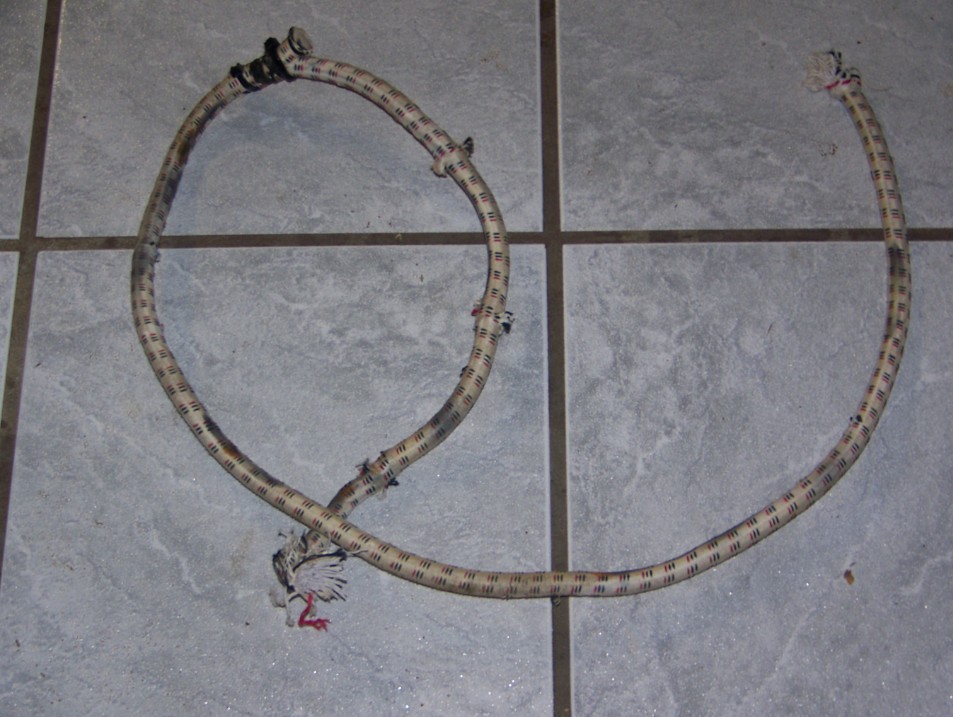

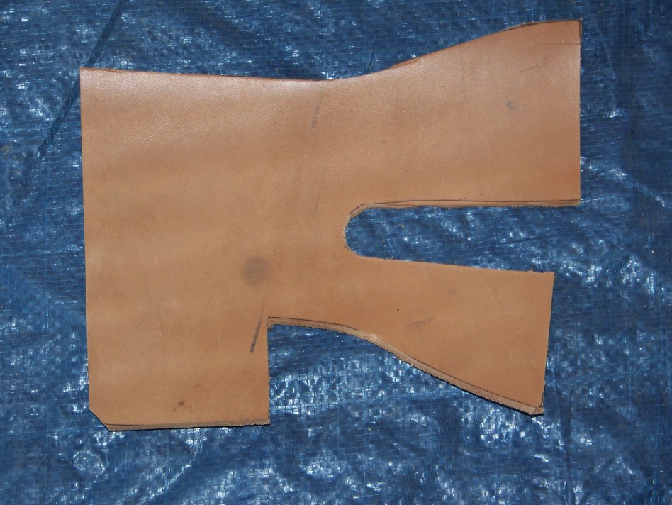

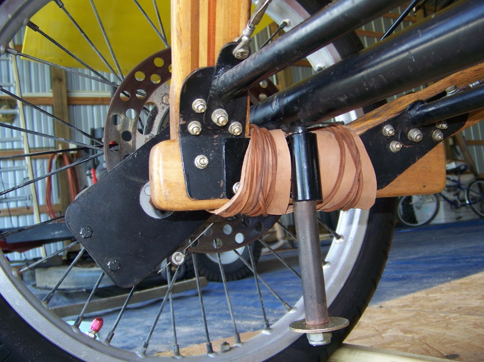

I was taxiing up in front of the hangar after flying when the left bungee broke
and a sick feeling came over me. The wingtip was still about waist high and no
damage. The attached pictures show my attempt at solving the problem of those
bolts cutting into the bungee cord. The leather is called "horse butt". It is
tough stuff. I wanted the firmer ride so we added a fourth wrap. I really like
the suspension now. I still moves but only when you hit a bump. Maybe I can
get at least a year out of the bungees. I figure on taking the leather off every
other year to check for rust under the leather. I really don't like covering
the steel up like that but couldn't think of a better fix. The big flat washer
and the unpainted tubing come off after the wrapping is done. The nut limits
the travel to about 4" inches.

Looks like a very nice solution to your fraying bungee issues Jerry. The bungee
wrap nearly covers your
entire leather wrap. Looks really good to me and you should get much longer life
out of your bungee shock cords.

| Subject: | Broken Bungee & How I repaired it |
Out West we have plenty of horses ass, but I haven't seen horse butt, except
at horse shows. So I just used some deer hide....as inspired by Greg
Cardinal. In the pics you will note that I did not lash it down as Jerry
did...because he always takes things to the next level; however, in 52 hrs,
my deer hide has not moved.
Gary Boothe
NX308MB
-----Original Message-----
[mailto:owner-pietenpol-list-server@matronics.com] On Behalf Of Jerry Dotson
Sent: Thursday, June 06, 2013 4:41 AM
Subject: Pietenpol-List: Broken Bungee & How I repaired it
--> <jdotson@centurylink.net>
broke and a sick feeling came over me. The wingtip was still about waist
high and no damage. The attached pictures show my attempt at solving the
problem of those bolts cutting into the bungee cord. The leather is called
"horse butt". It is tough stuff. I wanted the firmer ride so we added a
fourth wrap. I really like the suspension now. I still moves but only when
you hit a bump. Maybe I can get at least a year out of the bungees. I figure
on taking the leather off every other year to check for rust under the
leather. I really don't like covering the steel up like that but couldn't
think of a better fix. The big flat washer and the unpainted tubing come off
after the wrapping is done. The nut limits the travel to about 4" inches.
Jerry Dotson
First flight June 16,2012
Flying in phase 2
Lycoming O-235 C2C
Jay Anderson CloudCars prop 76 X 44
http://forums.matronics.com/viewtopic.php?p=402115#402115

| Subject: | Re: Broken Bungee & How I repaired it |
So guys. Given a chafe free install, how long do those bungees last?
Paul Donahue
Started 8-3-12
http://forums.matronics.com/viewtopic.php?p=402162#402162
Message 20
I don't know. Mine always chafe and have to be replaced about every 3 years
Jack Phillips
NX899JP
Smith Mountain Lake, Virginia
[mailto:owner-pietenpol-list-server@matronics.com] On Behalf Of nightmare
Sent: Thursday, June 06, 2013 8:22 PM
Subject: Pietenpol-List: Re: Broken Bungee & How I repaired it
<pauldonahuepilot@yahoo.com>
Paul Donahue
Started 8-3-12

Message 23
Well that doesnt seem too bad.
Paul Donahue
Started 8-3-12
http://forums.matronics.com/viewtopic.php?p=402169#402169
Message 24
NX18235 is going on 3 years since the leather anti-chafe installation. Prior
to that the bungees were being replaced annually. A most unpleasant job.
Greg Cardinal
----- Original Message -----
From: "nightmare" <pauldonahuepilot@yahoo.com>
Sent: Thursday, June 06, 2013 7:22 PM
> Paul Donahue
> Started 8-3-12
> do not archive
