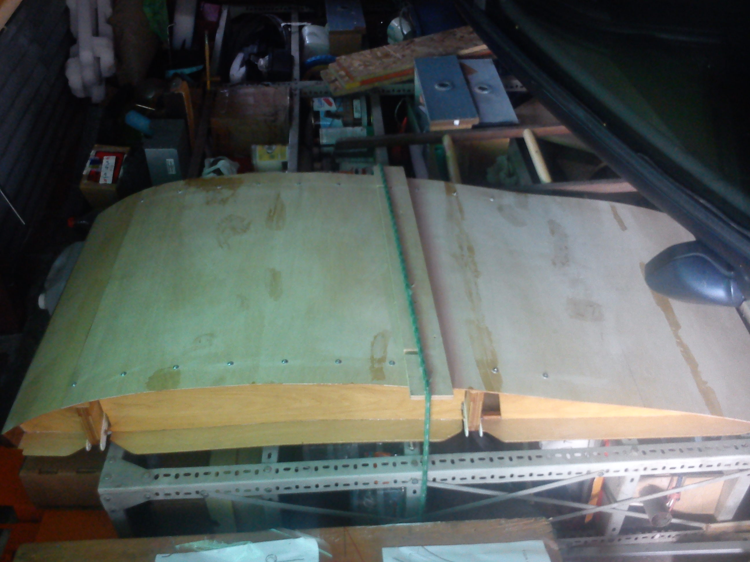

Hello,
I am covering the center section with a plywood foil of 3mm, a little fixed piece
in the leading edge, and a full one for the rest. I plan to attach it with
screws over the rib separated 4 inchs as you can see in the photo. I plan just
barnish it. the other side is the same, but instead of screwa it is attached
with epoxy.
I ask, this is the way to go?.
thank you
Mario Giacummo
Photos here: http://goo.gl/wh7M4
Little Blog : http://vgmk1.blogspot.com

Hi Mario,
It's your decision. Most builders epoxy plywood to the bottom for two
reasons: 1) To keep the center section square; 2) To act as a floor for
either a fuel tank or baggage. In either case, most are merely covered with
an aluminum top, fastened in a variety of methods. If you don't wish to put
anything in your center section, there is no reason why you couldn't add a
center rib and cover same as the wings.
Other than a different look and a little weight, I'm not sure what you gain
with a plywood top...but it won't hurt anything, either.
Gary Boothe

Realy, I ask because I do not see any center section cover. I always
thought plywood (or aluminium) is ok, but.. may be there is a reason why
not. I am going to put a tank in it, so the middle of the areas is a little
bit.... soft, that is why I ask, may be you do/put something inside, like
add a curved section to keep it a little more rigid, or not, it could be
unnecesary (I think is unnecesary, but I do not know)
It's ok. thank you
Mario Giacummo
2013/6/11 Gary Boothe <gboothe5@comcast.net>
> Hi Mario,
> Gary Boothe

> Hello,
> piece in the leading edge, and a full one for the rest. I plan to attach it
> with screws over the rib separated 4 inchs as you can see in the photo. I
> plan just barnish it. the other side is the same, but instead of screwa it
> is attached with epoxy.
> thank you
> Mario Giacummo

Mario, I have a plywood bottom and plan on an aluminum top.
Jack Textor

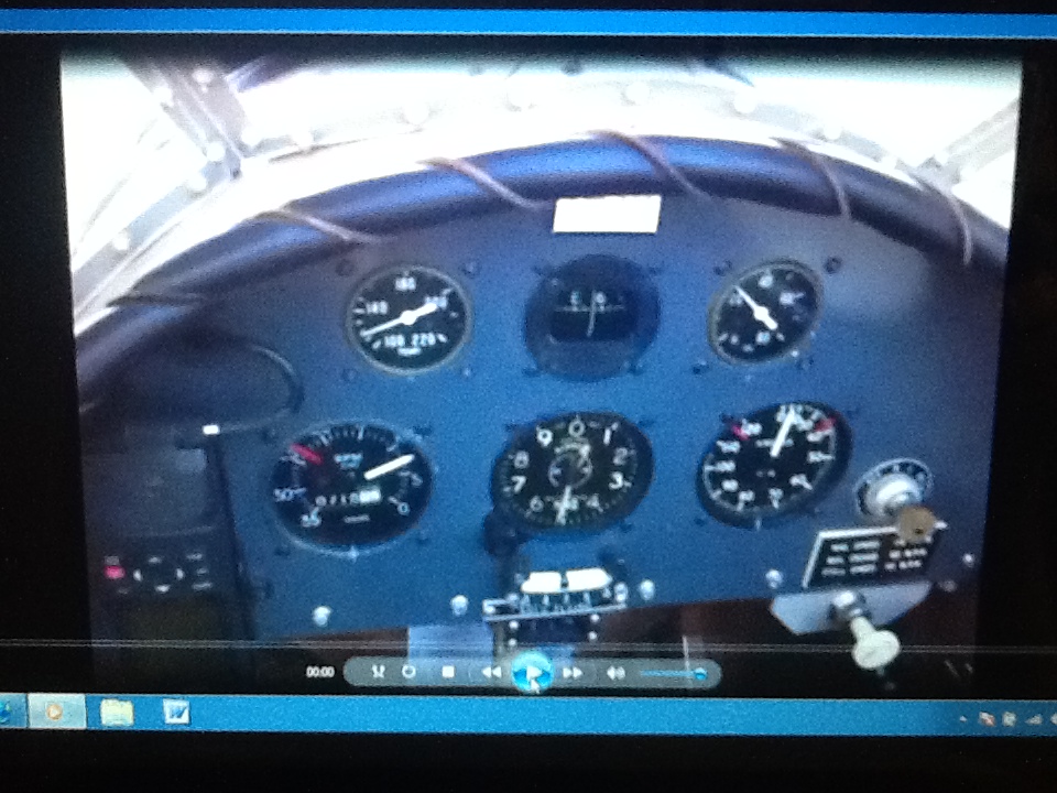

Hi Folks,
For the Continental powered machines: Just like to pass along some courtesy info,
incase someone building might be interested. If you like the older-style 270
deg sweep to your oil Temp/Press gauges w/out the clutter of wording written
all over the face of the gauge, I found that the WW2 Jeeps have the perfect Temp/Press
scale for small Continentals. Here is the Intel on where/how I got mine...
www.kaiserwillies.com
Oil Psi Item#A8190 $34
Oil Temp #A8188 $50
I needed a 90" Capillary line for my Temp Probe, so I mailed the gauge to:
Jeff Sunzeri
981 Alder Street
Hollister, CA 95023
jeffsunzeri@gmail.com
Having new Capillary put on and calibrated to read accurately costed me $95 including
shipping. Will attempt to attach short video inflight..
L.Metzel

thank you all, that's what I want to listen.
regards.

..couldn't get movie to load, but here's a fuzzy pic (idle power) from computer...as
you can see, the gauges fit the standard 2 1/8 inch holes in the instrument
panel. Taken before I added the tape markings for the limitations.
L.Metzel

Are the gauges "mechanical", do they work without an electrical system? The reference
in the catalogue to 12-24 volts refers to the lighting of the gauge only,
right?
Ray Krause

Yes...they are mechanical gauges. The electrical reference must mean for lighting...
Larry
