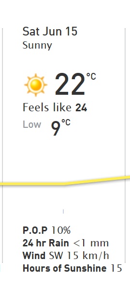

| Subject: | Re: Pietenpol Picnic |
Weather forecast for Saturday looks really good. Should be a good day.
Bill C.
http://forums.matronics.com/viewtopic.php?p=402615#402615

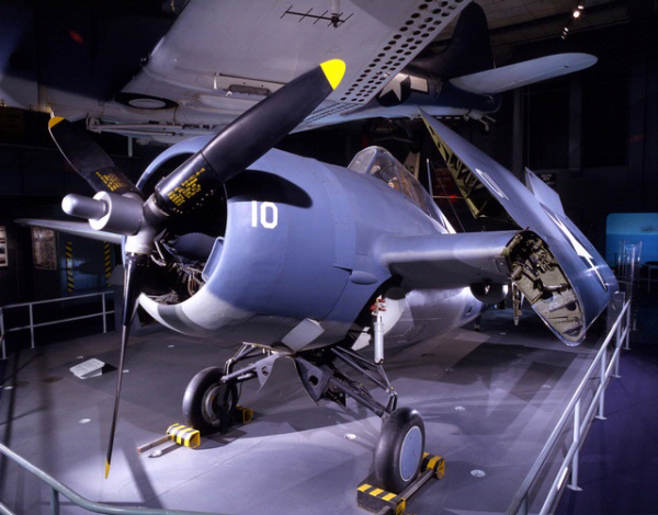

On Jun 12, 2013, at 10:58 PM, "jarheadpilot82" <jarheadpilot82@hotmail.com> wrote:
> Ken,
> Thanks for uploading the Forum paper about landing gear design.
> The last paragraph on page 1 gave me what I was looking for-
> "On a front view, the angle between vertical and a line from CG to point of wheel
contact with ground should not be less than 25 degrees."
> That is what I was looking for. With so many differing dimensions of gear width
that have been mentioned, I agree that some guidance needs to be published,
and this article gives it. My question pertained to the usefulness of the information,
and this article does put it to use. Thanks for bringing that out.
> I guess the Grumman engineers slept through the landing gear design class in
college when they designed the gear on the F4F Wildcat!
> Semper Fi,
> Terry Hand
> Athens, GA

Message 8
Ray - That is as viewed from the front, which would affect 'tippiness.'
Ken's brainiacs went on to consider that the vertical cg changes from tail
up to tail down....very clever...
I'm with you. LAR, and I knew my gear looked narrow!
> wrote:
> > --> <jarheadpilot82@hotmail.com>
> > Ken,
> of wheel contact with ground should not be less than 25 degrees."
> width that have been mentioned, I agree that some guidance needs to be
> published, and this article gives it. My question pertained to the
> usefulness of the information, and this article does put it to use. Thanks
> in college when they designed the gear on the F4F Wildcat!
> > Semper Fi,
> > Terry Hand
> > Athens, GA
>> Ken,
>> Semper Fi,
>> Terry Hand
>> Athens, GA
